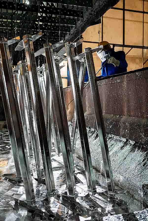

Galvanized fabrication withdrawn kettle 2
Hot-dip galvanizing protects steel from corrosion by immersing fabricated steel in molten zinc to create a durable zinc–iron alloy coating. This page explains how the process works, how it differs from other zinc coatings, and why it is a preferred corrosion protection method for structural and infrastructure applications.
When fabricated steel is immersed into a galvanizing kettle (bath) of molten zinc the iron in the steel metallurgically reacts with the zinc to form a tightly-bonded alloy coating. The origins of the process date back more than 250 years; however, new technologies and creative chemistry contribute to the continued evolution of this proven process.
