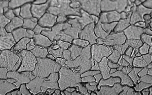

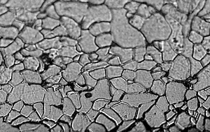

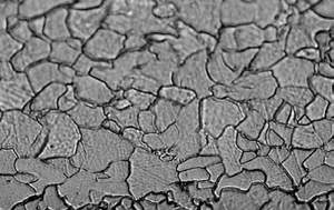

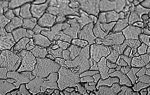

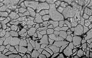

By Mittal Steel Ostrava, Vysoka Skola Banska In this study four types of steel were put through the galvanizing process to determine the effects of individual steps during the galvanizing process on the mechanical properties, impact strength, and microstructure of the tested steels. Testing of mechanical properties included upper yield point, ultimate strength, and ductility. The results of the test concluded differences in mechanical properties of steels that were not galvanized and those that were galvanized was negligible and galvanizing does not have any effect on mechanical properties of steel.
Fracture properties in this test included absorbed energy a notch toughness. Results of the tests showed measured differences between galvanized steel and steel that was not galvanized were very small and most likely attributable to microstructure heterogeneity. The overall conclusion was hot-dip galvanizing does not have any influence on fracture properties of steel. No differences were found in the microstructure of galvanized steel compared to steel that had not been galvanized.
