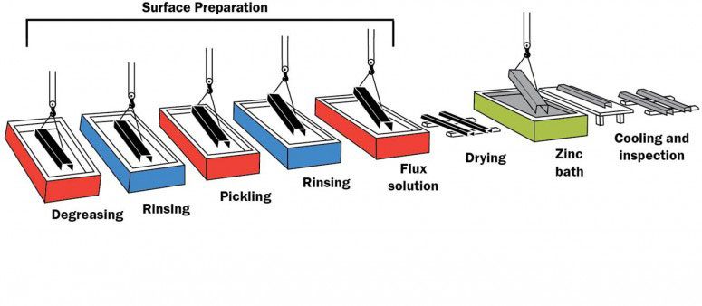

The hot-dip galvanizing (HDG) process consists of three basic steps:
Picture1 Gi 17
Surface Preparation
Surface preparation is a critical step in the application of any coating. The galvanizing process has its own built-in means of quality control because zinc will not react with an unclean steel surface. Any failures or inadequacies in surface preparation will be immediately apparent when the steel is withdrawn from the zinc bath because the unclean areas will remain uncoated, and immediate corrective action can be taken. Surface preparation for galvanizing consists of three steps:
Degreasing/Caustic Cleaning
A hot alkali solution, mild acidic bath, or biological cleaning bath removes organic contaminants such as dirt, paint markings, grease, and oil from the metal surface. Epoxy, vinyl, asphalt, or welding slag, which cannot be removed by degreasing, must be removed before galvanizing by grit-blasting, sand-blasting, or other mechanical means.
Chemical Cleaning
A dilute solution of heated sulfuric acid or ambient hydrochloric acid removes mill scale and iron oxides (rust) from the steel surface. As an alternative to or in conjunction with chemical cleaning, this step can also be accomplished using abrasive cleaning or air blasting sand, metallic shot, or grit onto the steel. As long as the surface of the steel is completely cleaned to bare metal and all non-metallic substances removed, the galvanizing reaction is indifferent to the manner of cleaning.
Fluxing
The final surface preparation step in the galvanizing process, a zinc ammonium chloride solution, serves two purposes. It removes any remaining oxides from the surface of the steel, and deposits a protective layer on the steel to prevent any further oxides from forming on the surface prior to immersion in the molten zinc.
Galvanizing
During the actual galvanizing step of the process, the material is completely immersed in a bath of molten zinc. The bath chemistry is specified by ASTM A123 and requires at least 98% pure zinc by weight maintained at a temperature above the melting point of zinc. The zinc metal in the bath must meet the requirements of ASTM B6 or ASTM B960.
While the steel is immersed in the kettle, zinc reacts with iron in the steel to form a series of metallurgically-bonded zinc-iron intermetallic alloy layers, commonly topped by a layer of pure zinc metal. Once the fabricated items’ coating growth is complete, it is withdrawn slowly from the galvanizing bath, and the excess zinc is removed by draining, vibrating, and/or centrifuging. The metallurgical reaction will continue after the materials are withdrawn from the bath, as long as the steel part remains near bath temperature. Galvanized articles are cooled either by immersion in a passivation solution or water, or by being left in open air.
