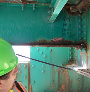

inspecting corrosion on a steel bridge
Inspection markings on this bridge show the ravages of corrosion.
