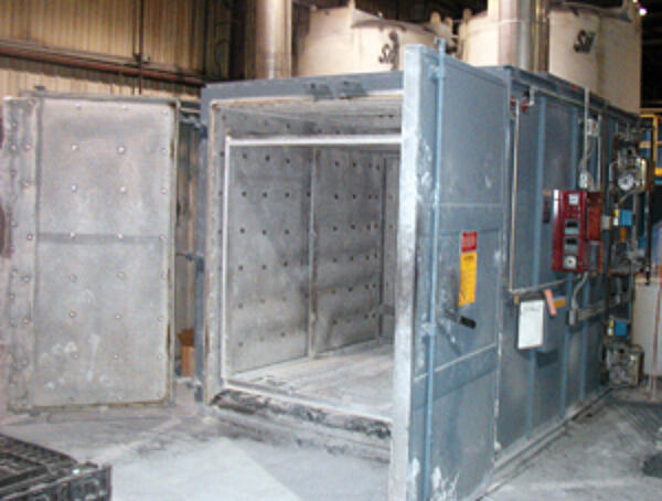

Powder coating oven used to cure the coating and outgas hot-dip galvanized pieces before powder coating
Once coated with powder, the piece is then cured in an oven heated to between 375 F and 400 F to melt, flow together over the piece, gel into a smooth film, and then dry with a firm, durable finish. The final coating can vary from high gloss to matte depending on the formulation of the powder.
