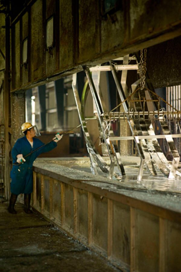

Batch hot-dip galvanizing, also known as general galvanizing, produces a zinc coating by completely immersing the steel product in a bath (kettle) of molten zinc. Prior to immersion in the zinc bath, the steel is chemically cleaned to remove all oils, greases, soil, mill scale, and oxides. Surface preparation is critical as zinc will not react with unclean steel.
removal of an article from the molten zinc galvanizing bath
After surface preparation, the steel is immersed in the molten (830 F) zinc bath. The bath consists of more than 98% pure zinc and the remaining 2% or less consists of additives - most commonly aluminum, nickel, and bismuth. These additives help with zinc fluidity and consumption, coating appearance, and other efficiencies. While in the galvanizing kettle, the molten zinc metallurgically reacts with the iron in the steel to form the coating.
