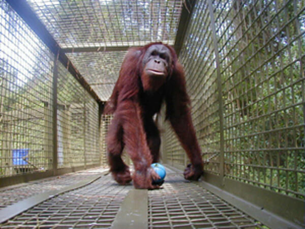

Center for Great Apes
Duplex systems are most commonly specified for aesthetic reasons. However, paint or powder coating can also be added to galvanizing in very aggressive environments or for color coding as well as to extend the life of existing galvanized structures. The key to a successful duplex system is to properly prepare the galvanized surface for paint or powder according to ASTM D6386 and ASTM D7803, the primary industry standards for preparing hot-dip galvanized surfaces prior to painting and powder coating.

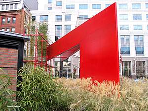

Chinatown Park duplex system
This is not to suggest the original paint or powder coating will last more than a century. Rather this lifetime assumes no maintenance will be performed and the paint or powder coating would naturally wear away, and then the galvanizing would provide corrosion protection for the remainder of the life. However, the owner will likely want to maintain the paint/powder system for aesthetics. So in practice, the synergistic effect is realized in the delayed maintenance cycle (touch-up, maintenance paint, and full repaint) of the paint/powder coating of the duplex system. The maintenance cycle for paint/powder on galvanized steel is 1.5 to 2 times the cycle for paint/powder on bare steel.
