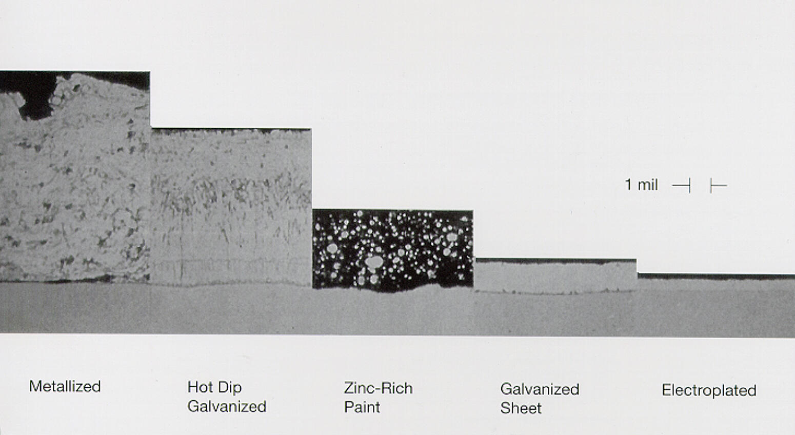

Photomicrograph comparison of various zinc coatings

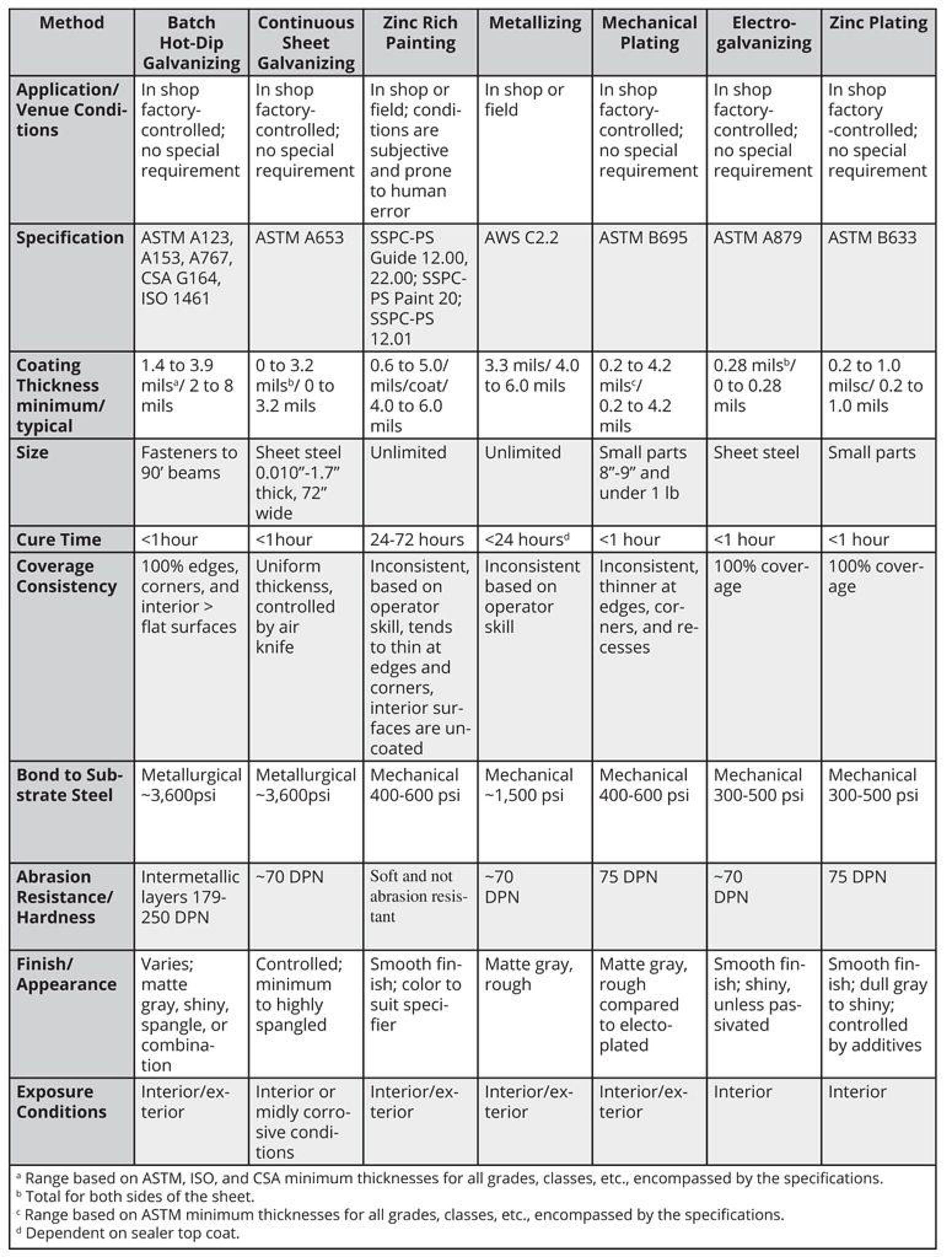

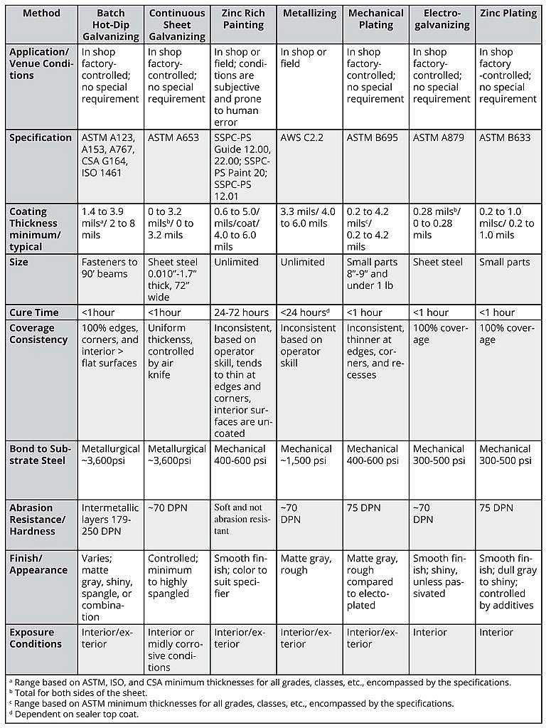

Method Batch Hot-Dip Galvanizing Continuous Sheet Galvanizing Zinc Rich Paint Thermal Spray Zinc Metallizing Mechanical Plating Electro-galvanizing Zinc Plating
Application / Venue Conditions In shop, factory controlled; no special requirement In shop, factory controlled; no special requirement In shop or field; conditions are subjective and prone to human error In shop or field In shop, factory controlled; no special requirement In shop, factory controlled; no special requirement In shop, factory controlled; no special requirement
Specification ASTM A123, A153, A767, CSA G164, ISO 1461 ASTM A653 (i.e. G60, G90 coating grade designations) SSPC-PS Guide 12.00, 22.00; SSPC-PS Paint 20; SSPC-PS 12.01 AWS C2.2 ASTM B695 ASTM A879 ASTM B633
Coating Thickness Minimum / Typical 1.4-3.9 milsa / 2-8 mils 0-3.2 milsb / 0-3.2 mils 0.6-5.0 mils per coat / 4.0-6.0 mils per coat 3.3 mils / 4.0-6.0 mils 0.2-4.2c mils / 0.2-4.2 mils 0.28 milsb / 0-0.28 mils 0.2-1.0 milsc / 0.2-1.0 mils
Size Small parts and fasteners to 90' beams Sheet steel 0.010" - 1.7" thick, 72" wide Unlimited Unlimited Small parts 8-9" and under 1 lb Sheet steel Small parts
Cure Time < 1 hour < 1 hour 24-72 hours < 24 hoursd < 1 hour < 1 hour < 1 hour
Coverage Consistency 100% flat surfaces, edges, corners, and interior Unknown thickness, controlled by air knife Inconsistent based on operator skill, tends to thin at edges and corners, interior surfaces are uncoated Inconsistent based on operator skill Inconsistent thinner at edges, corners and recesses 100% coverage 100% coverage
Bond to Substrate Steel Metallurgical ~3,600 psi Metallurgical ~3,600 psi Mechanical 400-600 psi Mechanical ~1,500 psi Mechanical 400-600 psi Mechanical 300-500 psi Mechanical 300-500 psi
Abrasion Resistance / Hardness Intermetallic layers 179-250 DPN ~70 DPN Soft and not abrasion resistant ~70 DPN 75 DPN ~70 DPN 75 DPN
Finish / Appearance Varies; matte gray, shiny, spangle or a combination Controlled; minimum to highly spangled Smooth finish; color to suit specifier Matte gray, rough Matte gray, rough compared to electroplated Smooth finish; shiny, unless passivated Smooth finish; dull gray to shiny; controlled by additives
Exposure Conditions Interior / exterior Interior or mildly corrosive conditions Interior / exterior Interior / exterior Interior / exterior Interior Interior
a Range based on ASTM, ISO, and CSA minimum thicknesses for all grades, stylees, etc., encompassed by the specifications.
b Total for both sides of the sheet
c Range based on ASTM minimum thicknesses for all grades, stylees, etc., encompassed by the specifications.
d Dependent on sealer top coat

The service life of zinc coatings is a linear function of the zinc coating thickness. However, zinc coating thickness alone can be deceiving when evaluating zinc applied by different processes. In addition to thickness, the amount of available zinc per unit volume, or density, is also important.
Various ASTM and/or other specifications require different weights or thicknesses, so it is imperative to convert all coatings to a common denominator for comparison. While coating densities for some types of zinc coatings are nearly identical, others differ considerably. The coating densities, in terms of thickness required to equal 1 oz of zinc per square foot of surface, are:
Coating Thickness to reach 1 oz/ft2
Hot-dip galvanizing (batch or continuous), electroplating, zinc plating 1.7 mils (43 µm)
Metallizing (zinc spraying) 1.9 mils (48 µm)
Mechanical plating 2.2 mils (55 µm)
Zinc-rich paint 3-6 mils (75-150 µm)
Each of these thicknesses, representing the same weight per unit area of zinc, would be expected to provide equivalent service life; i.e. 1.7 mils of hot-dip galvanized would give about the same service life as 2.2 mils of mechanical plating or 3-6 mils (depending on the paint formulation) of zinc-rich paint, assuming bond strength and edge protection are not factors.
