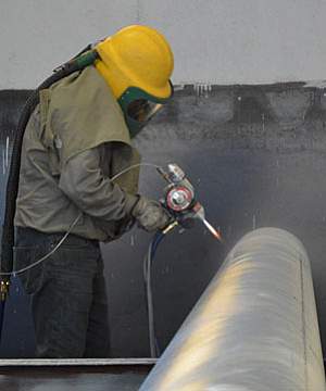

Zinc spraying, or metallizing, is accomplished by feeding zinc wire or powder into a heated gun, where it is melted and sprayed onto the part using combustion gases and/or auxiliary compressed air to provide the necessary velocity. Prior to metallizing, the steel must be abrasively cleaned.
Zinc spray, which is also referred to as metallizing.
The 100% zinc coating can be applied in the shop or field, but is more commonly done in the shop where heat for melting is more readily available. Metallizing may be used on any size steel, though the complexity of the structure is important, as applying a consistent coating and reaching recesses, hollows and cavities is difficult. Zinc spray is often used as an alternative to hot-dip galvanizing when the part is too large for immersion in the kettle and is also a great option for extending the life of already erected galvanized structures. The biggest limitations to metallizing applications are the availability of skilled operators and equipment and a significant cost premium.
