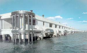

Seawater temperature can vary widely from 28.4 F (-2 C) at the poles to 95 F (35 C) near the equator. The higher the temperature the greater the dissolution of zinc in water. Tropical seawater (higher temperatures) yields higher corrosion rates, especially in polluted waters. Tidal zones and fluid agitation are also important considerations in determining the corrosion protection delivered by galvanized steel. Often, this motion of "washing" the carbonates off the zinc surface and not allowing them to form a protective film, along with zinc erosion, is the cause for base steel corrosion.
