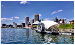

Water Wheel03

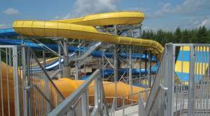

Calipso Water Park
Pools, Waterparks, and Aquatic Facilities
For many chlorinated water projects, hot-dip galvanizing has demonstrated good performance for decorative components as well as support structures, canopies, stairways, and handrails. Though regular splashing from chlorinated water results in the additional buildup of corrosion products (zinc chlorides), regular rinsing and drying in combination with seasonal use results in only a moderate effect on corrosion rate. Where additional protection from chlorine exposure is required, it can be practical to specify a duplex system.
The use of hot-dip galvanized steel immersed in pool water is not a typical application. Given the fluctuating water properties and high levels of chlorine, a high or variable corrosion rate can be expected. The coating may perform anywhere from a few months to a few years. Meanwhile, hot-dip galvanized steel has demonstrated good performance when used indoors above chlorine and saltwater pools. Though often a humid environment, suitable protection is given to columns, roofing beams, joists and other steel around the pool where direct chlorine exposure is minimized. For additional corrosion protection, or where aesthetics are a consideration, a duplex system can be specified.
