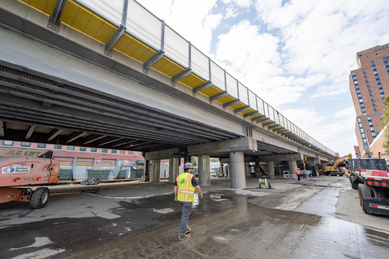

6 MTA 2393
Park Avenue Viaduct Replacement in New York City.

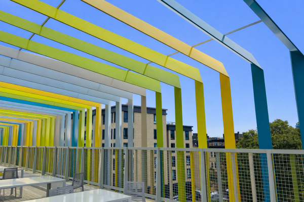

William E Carter School 9
William E. Carter School in Boston, Massachusetts.
In many cases, duplex systems are selected primarily for appearance: the project team wants the durability of galvanized steel, but in a color other than gray. They also make sense in aggressive environments because duplex acts as a performance multiplier: the paint shields the zinc from weathering, and the zinc continues protecting the steel if the paint is damaged. This is known as the synergistic effect: duplex systems often provide 1.5 to 2.3 times the service life of either coating used alone.
In practical terms, applying paint or powder coating over galvanized steel can significantly extend maintenance intervals compared with paint on bare steel, reducing recoating frequency and lowering life-cycle cost.

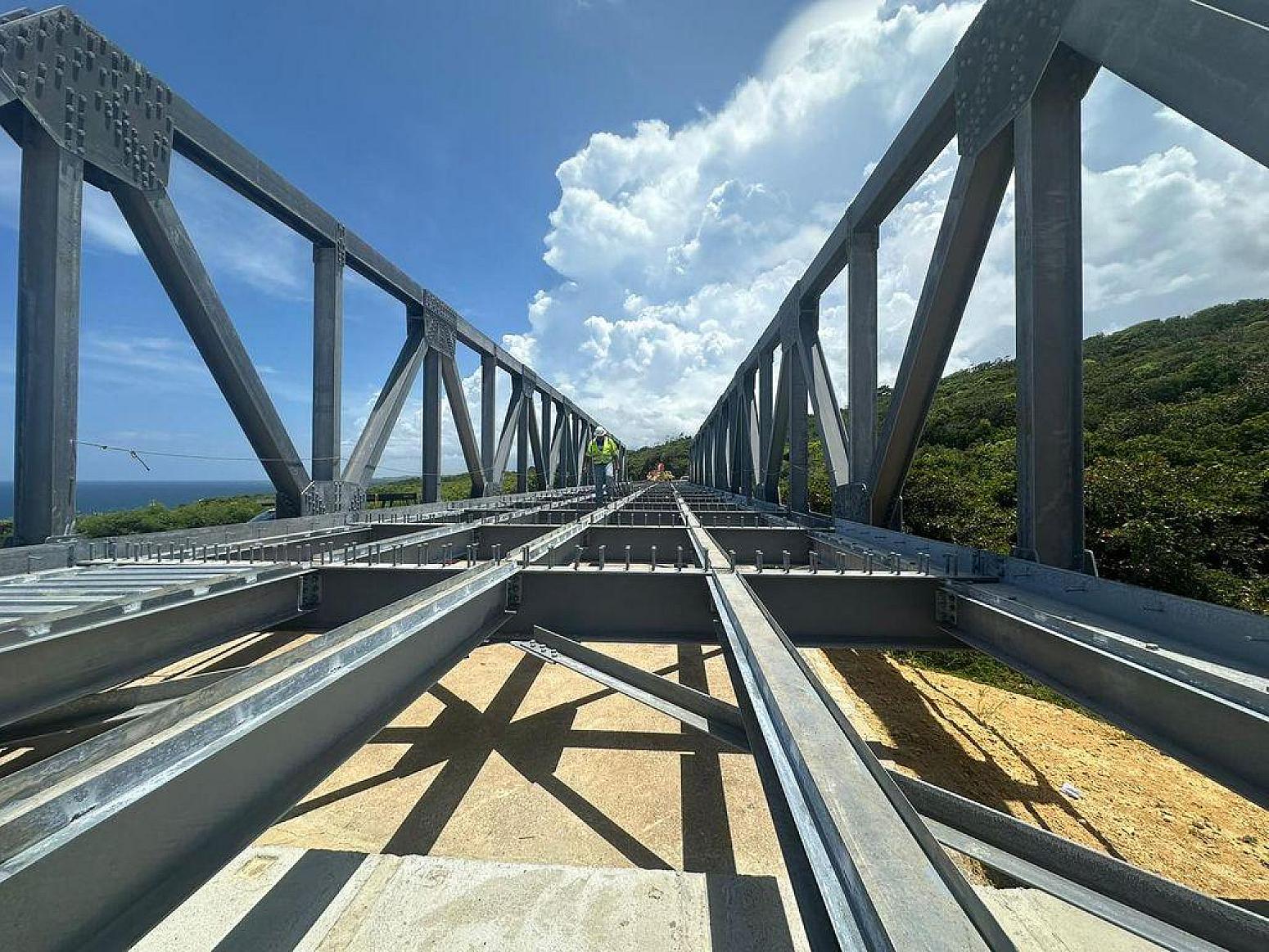

P jpeg 2 1765464073
Puente Blanco De Quebradillas Bridge in Quebradillas, Puerto Rico

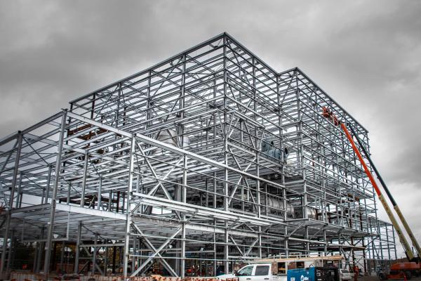

SUCRO STILLS November 1 11
Sucro Sugar Refinery in Hamilton, Ontario.
