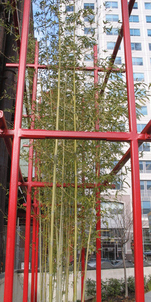

Chinatown Park
Painted Duplex System
*Updated 2023
Making paint recommendations can be tricky. First, it could reflect poorly on you or your company if a recommendation turns out problematic. Second, it’s best to leave paint recommendations up to paint suppliers or specialists. Having said that, many types of paint have been applied to hot-dip galvanized steel over the years. Some patterns have emerged with specific types of paint in particular environments, some working better than others.
In the AGA publication, Duplex Systems, you will find a table (Figure 1, below) that discusses the compatibility of 16 types of paint or other barrier coatings that have been applied over hot-dip galvanized steel. While this information should not be looked at as a recommendation, it can be used as a resource to assist in choosing an appropriate type of paint or barrier coating to apply over hot-dip galvanized steel. However, the specific type of paint or other barrier coating that will be applied over the hot-dip galvanized steel is only part of the formula for ensuring a successful duplex system. The other part of the formula, and probably the most important, is the preparation of the galvanized coating prior to applying the paint. If the preparation of the galvanized coating is inadequate, it does not matter what type of paint is used, it will begin peeling off the galvanized coating sooner rather than later.
Clients asking for recommendations should also be made referred to SSPC Guide 19. Guide 19 addresses both the condition of galvanizing and the application’s service environment to narrow down types of paint that are compatible under these circumstances. Using Guide 19’s Table 1, you can easily see what paint types are recommended before exploring further options with a paint supplier. For example, on a deteriorated hot-dip galvanized coating in a chemical (<5pH or >10pH) environment, bituminous, coal tar epoxy, and epoxy paint types, would be recommended.
