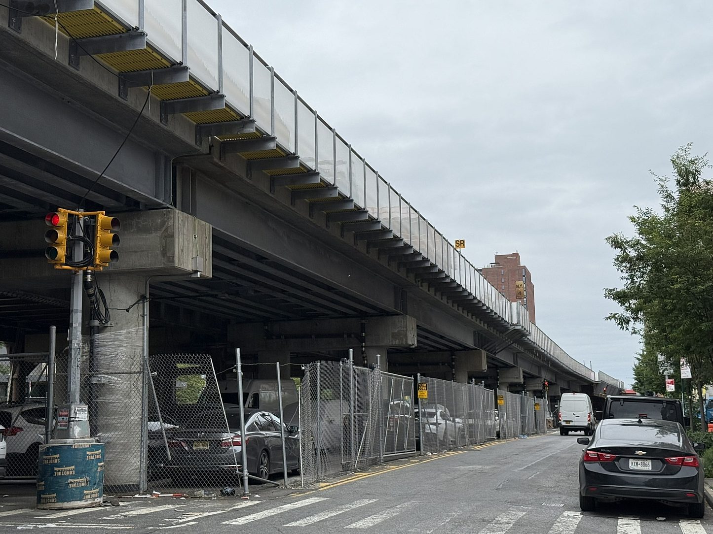

The work is being completed in phases to minimize community and service impacts. Phase 1, from East 115th Street to East 123rd Street, began in 2023 and was completed in in October of 2025, including replacement of steel spans, foundations, and integrated track, power, and signal systems.

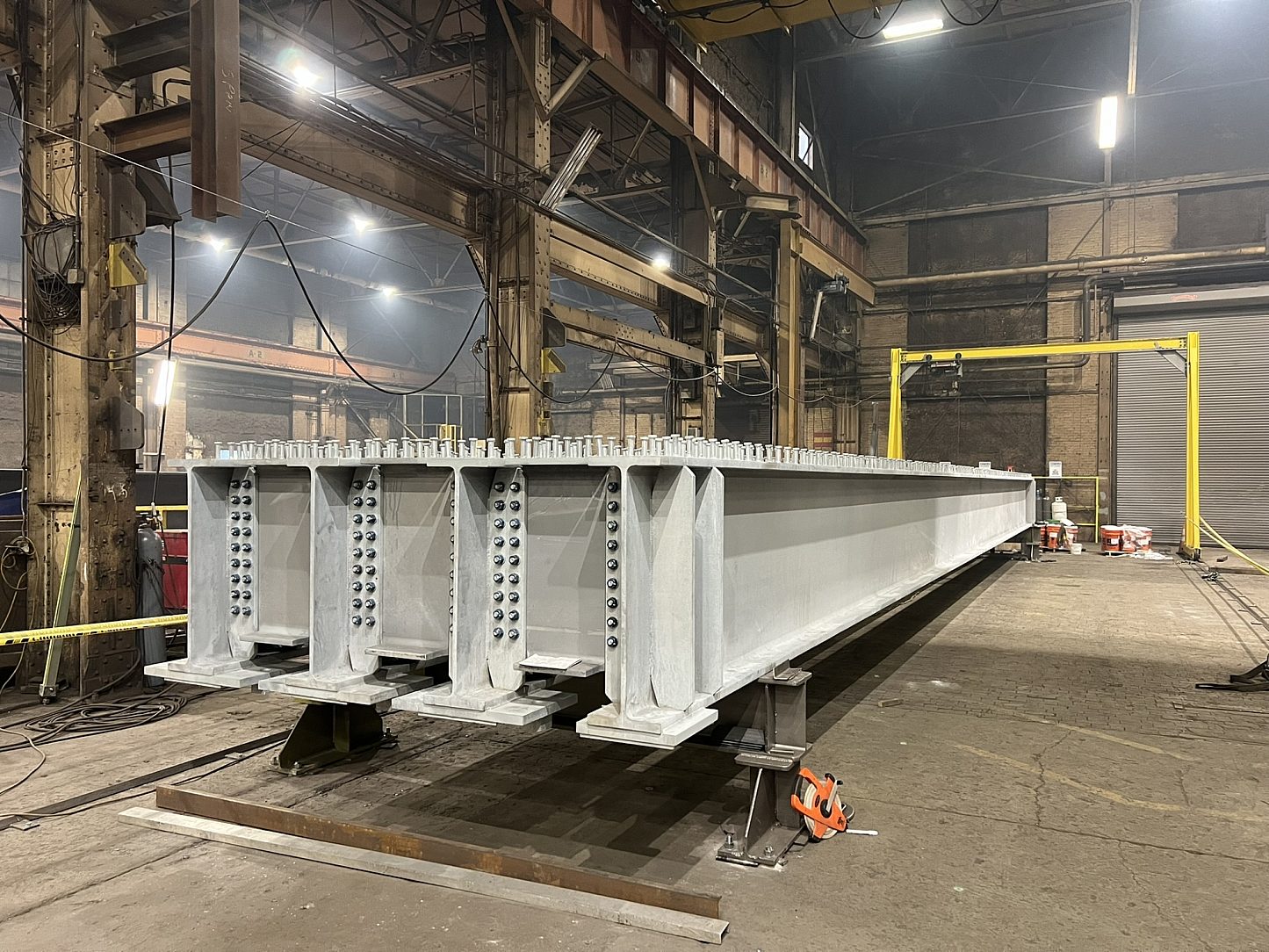

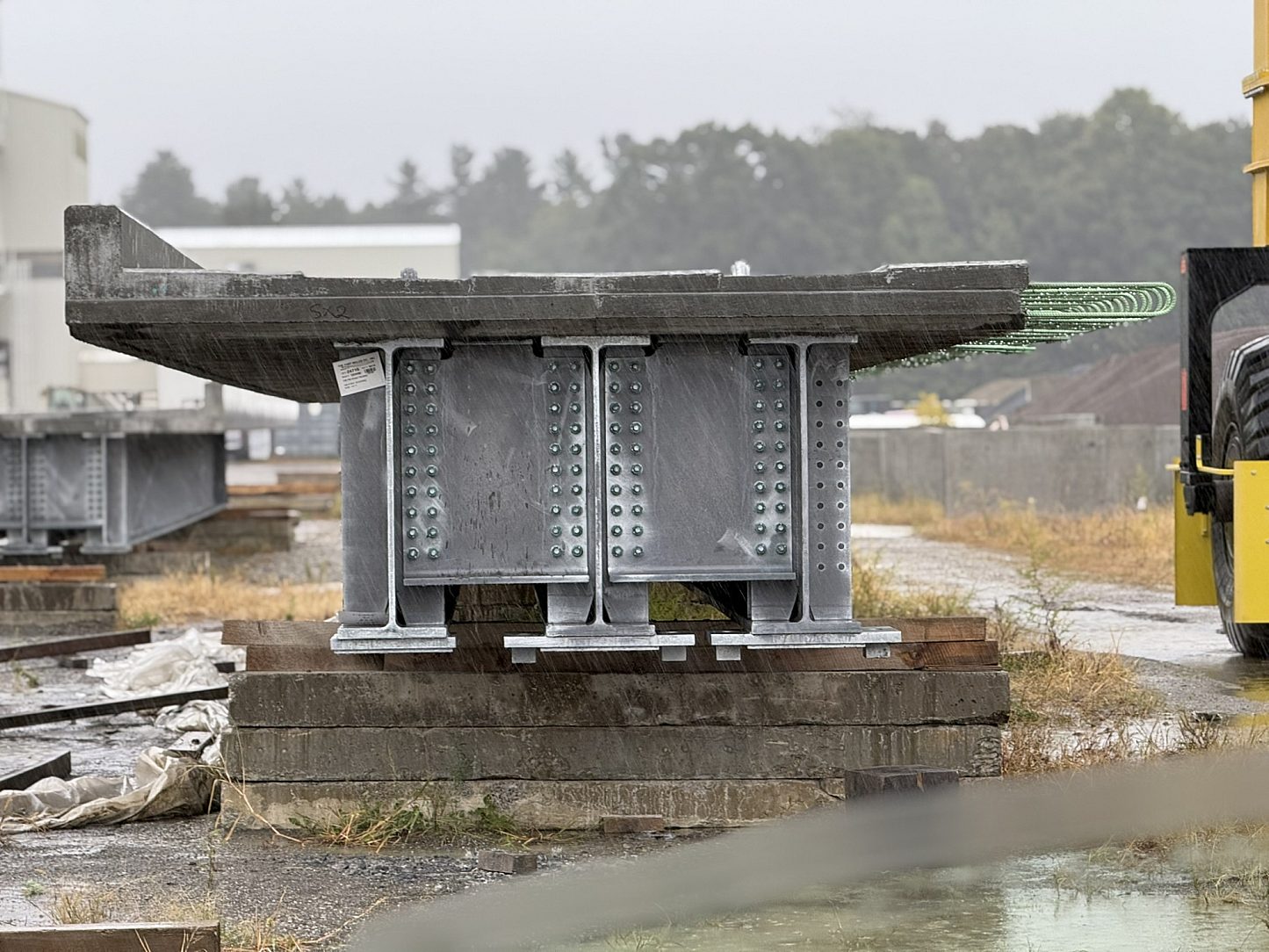

HDG steel was required, in part, due to numerous feedback from the community on their desire to lighten up the existing brown. This was discussed extensively with New York Stat Historic Preservation Office (SHPO) and after an exhaustive investigation process, SHPO approved the use of hot dip galvanized steel as it also was similar to the original PAV from the 1890s. There is also a big maintenance savings using HDG as well as an environmentally friendly advantage to HDG.

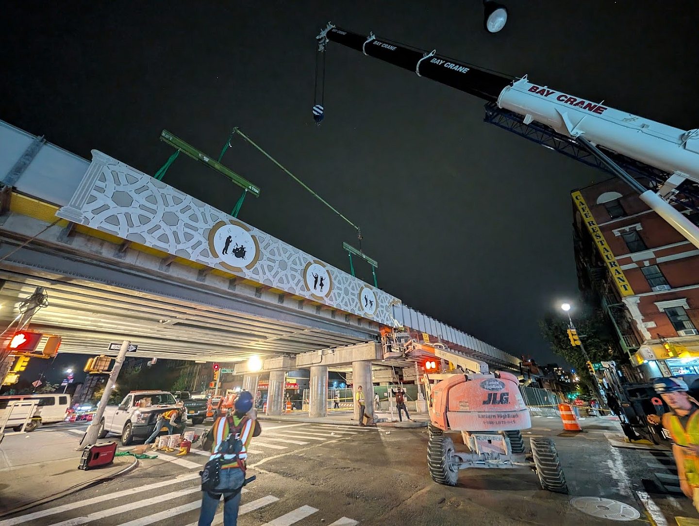

Halmar International, the project’s design-build contractor, replaced 8,240 feet of aging track along the Park Avenue Viaduct through the installation of 128 new prefabricated bridge sections all while keeping Metro-North Railroad service operational. The construction approach, developed collaboratively during the design-build procurement phase with the MTA, allowed the contractor to propose innovative methods that avoided extended service shutdowns and enabled multiple work phases to advance simultaneously.

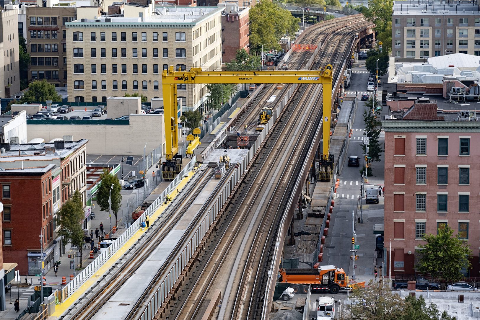

Central to the operation was a custom gantry system spanning Park Avenue, including three 60-foot-tall 200 ton Mi-Jack gantries used to remove deteriorated steel and concrete deck segments and set new bridge units into place. Work was completed over 19 weekend outages beginning in June 2024, allowing two tracks at a time to be taken out of service while maintaining active rail operations on the other two adjacent tracks to keep the track operational.

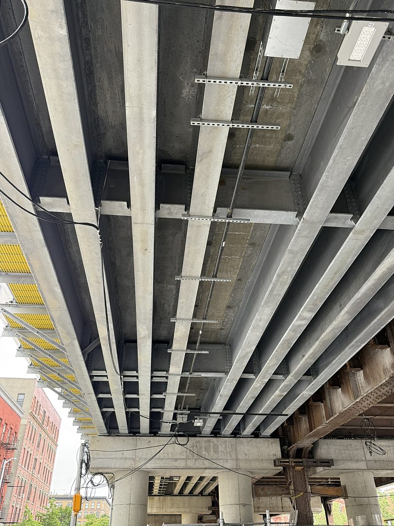

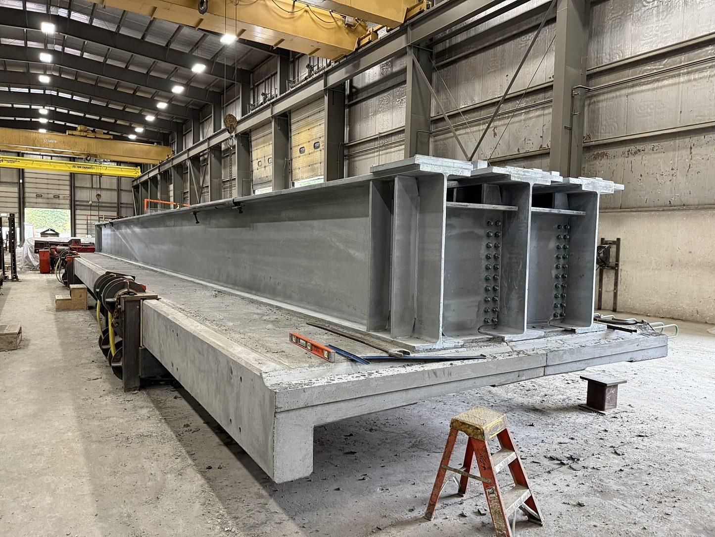

496 girders. Including Plate girders (2-3/4” flange & ¾” web), W40x235’s and W44x290 at 62’-65’ in length.
Steel: 4680
HDG: 4680
