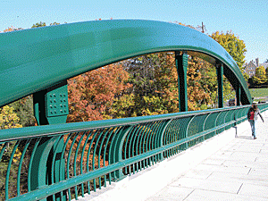

Thurston Ave Bridge Duplex Coated for Corrosion Protection
The Thurston Avenue Bridge is duplex coated for corrosion protection

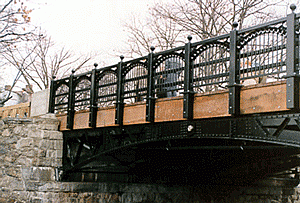

Duplex Painted Galvanized Steel Bridge

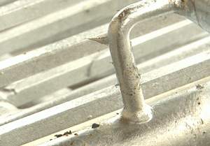

Zinc Spike Drip
Upon withdrawal from the zinc bath, sometimes excess zinc is present in small bumps, runs, or drips. These imperfections will be visible and/or could protrude through the paint coating; and therefore, must be removed prior to painting the part. Runs, drips, or bumps can be removed by grinding or filing the surface smooth and flat. Since pure zinc is a soft metal, care must be taken to remove the excess zinc material and leave a flat surface without removing the underlying zinc coating. The most common practice for removal is to use a hand grinder and lightly abrade away the excess zinc until the surface is flat and smooth. This must be completed before the removal of organic compounds, so the dust and powder can be removed by chemical cleaning.

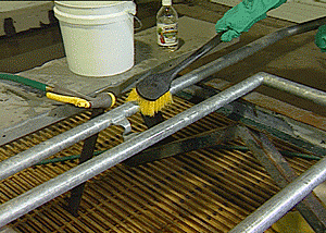

Cleaning Galvanized Steel Zinc Coating Surface With a Brush
Organic contaminants can also be removed with a mild acidic solution, a mixture of 25 parts water to one part acid. The acidic solution will also slightly etch the zinc coating and leave the surface a dull gray color. Acidic solutions are usually brush applied and should be thoroughly rinsed off the part with fresh water no later than two to three minutes after application. It is good practice to rinse the part twice after using acidic solutions for cleaning.

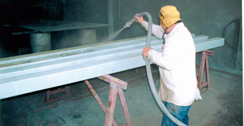

Upon completion of cleaning, the galvanized surface must be profiled to provide an anchor for the paint. Profiling the surface means to roughen all surfaces to be painted to promote better paint adhesion. There are four potential methods to profile the surface for paint: sweep blasting, wash primer, acrylic pretreatment, and surface grinding.
Sweep Blasting
Sweep blasting is the most common method, but care is required to not damage the relatively soft zinc coating. Unlike standard blasting, which uses a 90-degree angle, sweep blasting galvanized steel is done at an angle of 30 to 60 degrees. Additionally, the abrasive material must be chosen carefully, as some shot materials are too abrasive. Materials should have a particle size between 200 to 500 micrometers and a Mohs hardness of five or less.
Profiling the Zinc Coating Surface using Sweep Blasting to Prepare for Painting
Sweep blasting is the preferred method of profiling because of the soft nature of the zinc surface.

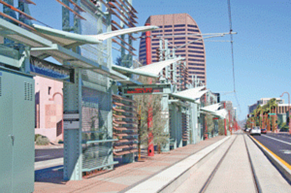

Valley Metro Rail Station Duplex System
The paint over HDG steel corrosion protection system will protect this light rail station structure for generations to come.
