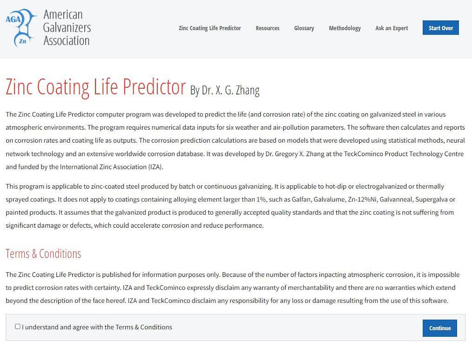

Working through a step-by-step example here will best explain how to use this valuable tool. We will use the specific example of the atmospherically exposed hot-dip galvanized steel of the Tappan Zee bridge spanning the Hudson River in New York. The Zinc Coating Life Predictor is accessed at zclp.galvanizeit.org. Accepting the terms and conditions and selecting the "continue" button will lead you to the model for input of project-specific climate data.

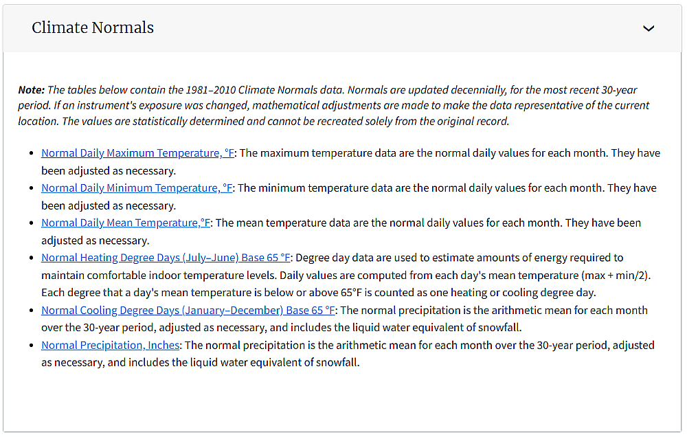

Rain or Precipitation is the first parameter needed by the ZCLP. The CCD website provides a report on the average rainfall information under "Climate Normals" called Normal Precipitation, Inches. Here we are interested in the total annual average value. This report contains tables of data arranged by meteorological elements, with weather stations listed alphabetically by state.
After locating the state of New York, you will notice it has nine weather stations to choose from. A quick look at a map will tell you the "NEW YORK Central Park,NY" is the closest listed station to the Tappan Zee Bridge (about 25 miles). The Precipitation chart within the CCD arranges precipitation data for each station by rainfall per month, per year, and the number of years represented by the data. Here, we are only interested in the total annual average (the last column "ANN") and find it is 49.94 inches for the Tappan Zee Bridges climate. This number is entered into our model and inch/year is selected on the drop-down menu next to rainfall to give the correct units.

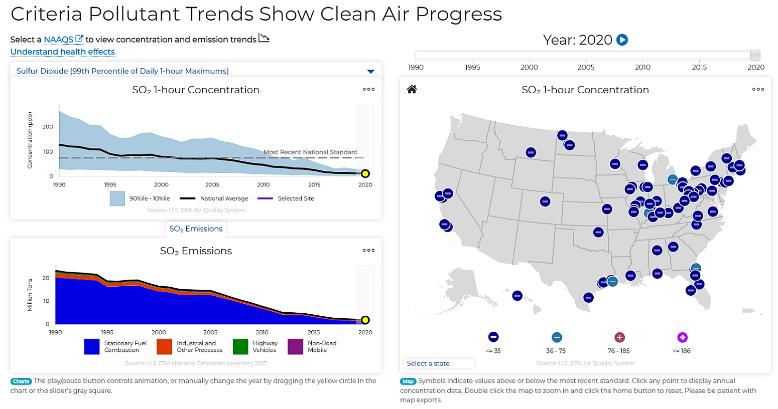

Sulfur Dioxide can either be measured by the deposition rate onto surfaces, or by the concentration of the pollutant in the air. For our purposes we will use the air concentration value. The Environmental Protection Agency (EPA) monitors air quality, including sulfur dioxide content, at several stations around the United States. Their website on NAAQS Trends contains a drop down menu on the top left chart, where you can select "Sulfur Dioxide 99th percentile of Daily 1-hr Maximums." Afterward, click on the menu in the bottom left corner of the US map image to select New York State. Zoom in in on the map to the Tappan Zee Bridge will show locations marked by a pin, where SO2 data is taken. SO2 levels (in ppb) for a number of years are available as well as trends in SO2 levels to help make predictions for future corrosion rates. There is also an option to download the data from this graph and view it on an Excel spreadsheet.
These steps were followed for the Tappan Zee Bridge area and it was found that the SO2 levels for this area are about 14 ppb or 5.34 micrograms per cubic meter. This value is entered into our model, making sure we change the units in the right drop down menu to μg/m3.

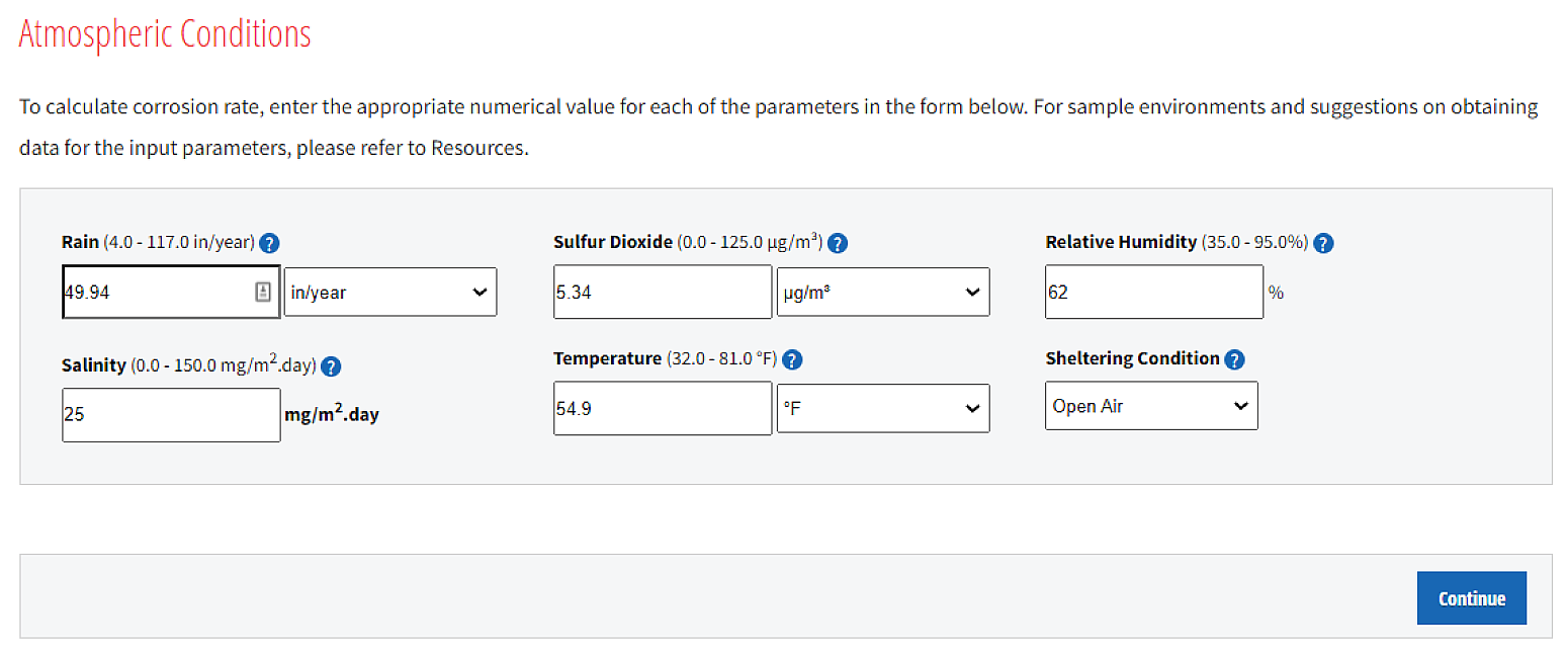

    Now that we have found the data needed for the ZCLP to make a prediction, it may all be entered into the ZCLP and a time to first maintenance prediction can be made.
    Table: Inputs for Tappan Zee Bridge Projects
    Yearly Average Rainfall
    49.94 inches
    Yearly Average Relative Humidity
    62% RH
    Yearly Average Temperature
    54.9 degrees Fahrenheit
    Sulfur Dioxide (SO2) Deposition
    5.34 μg/m3
    Air Salinity
    25 mg/m2 per day
    Sheltering Condition
    Open Air

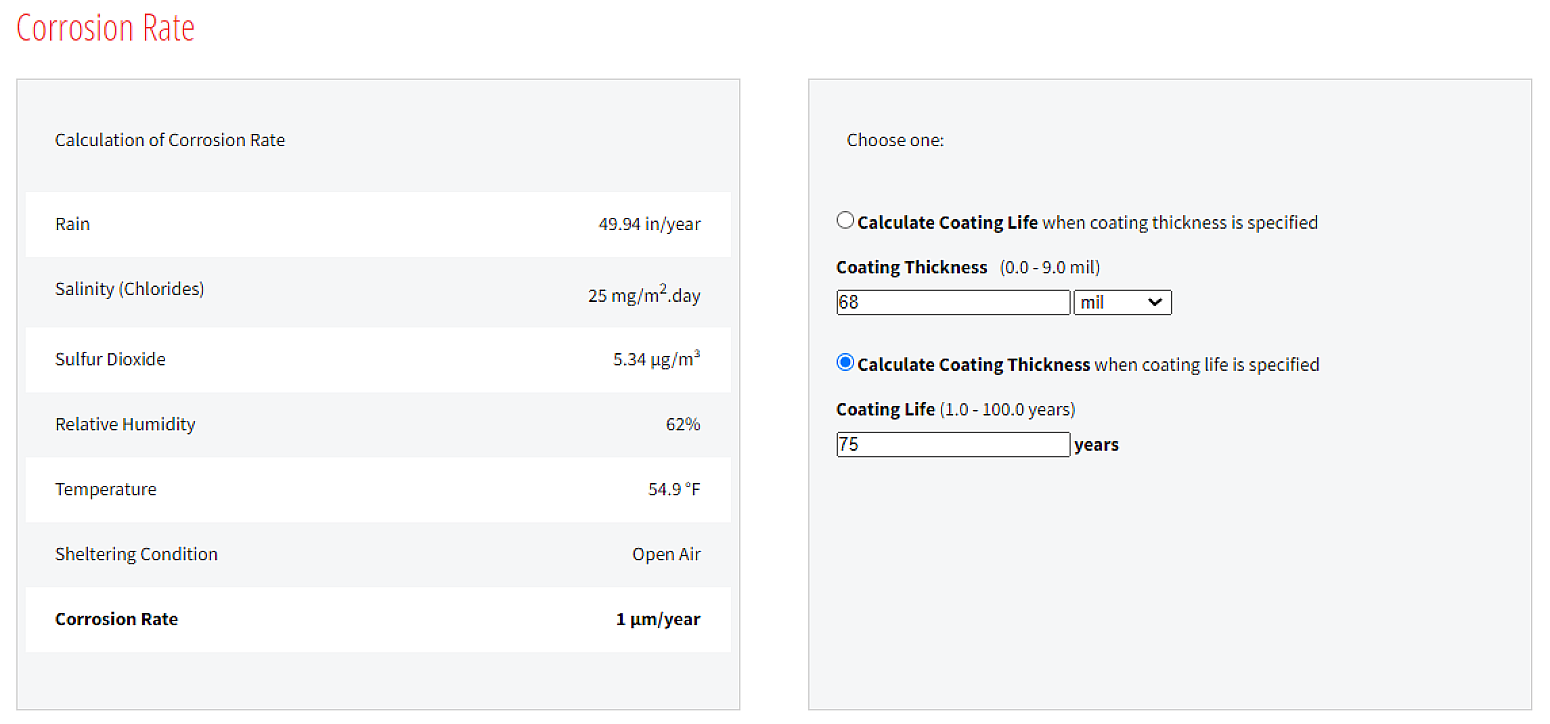

    After the data above has been entered and the correct units have been selected (Figure 5), clicking on the Continue button leads us to a new screen (Figure 6) with options for predicting the life of the coating based on a determined thickness, or for determining what thickness of coating is needed to last a determined amount of time.
    Figure 5
    Figure 5: Input Parameters Into ZCLP
    Figure 6
    Figure 6: Calculate Coating Thickness Based on Service Life

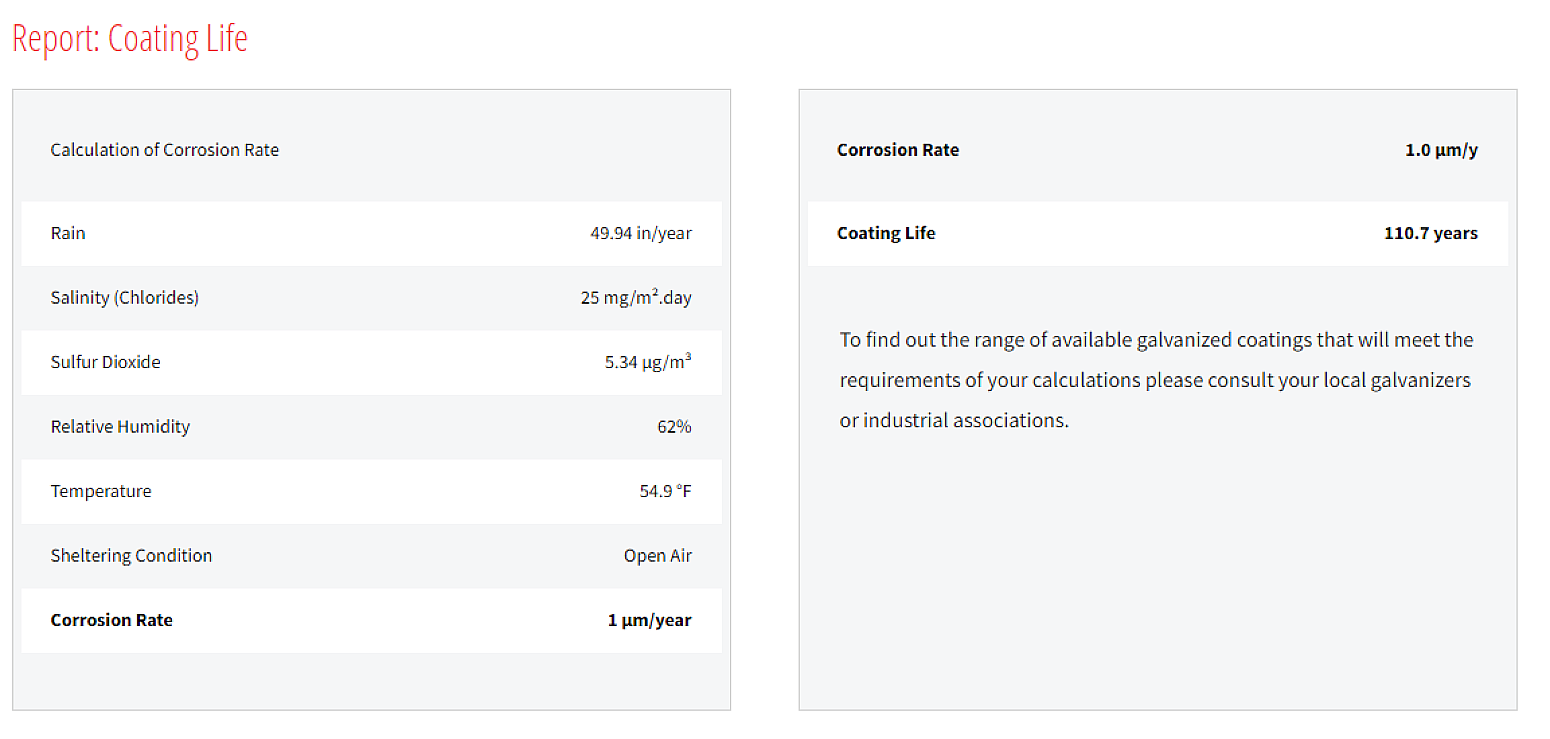

    Calculate Coating Life will predict the amount of time it will take for zinc coating to degrade based on the factors previously entered and the specified coating thickness. ASTM A123 specifies a minimum coating thickness of 3.9 mils (100 micrometers) for thicker structural steel pieces like those used in the construction of the Tappan Zee Bridge. Here, we will enter this minimum specified thickness into the ZCLP. Keeping in mind, however, that this is only a minimum thickness required and the actual measured thickness may be greater than this value. When this coating thickness is input into the ZCLP with the correct units selected, and Calculate Life is clicked on, a new page (Figure 7) appears with a readout of corrosion rate and predicted coating life.
    For the Tappan Zee Bridge, the rate of corrosion is predicted at 1µm/yr (0.04 mils/year) with a coating life of 110.7 years.
    Figure 7coating life
    Figure 7: Calculate Coating Service Life based on Coating Thickness

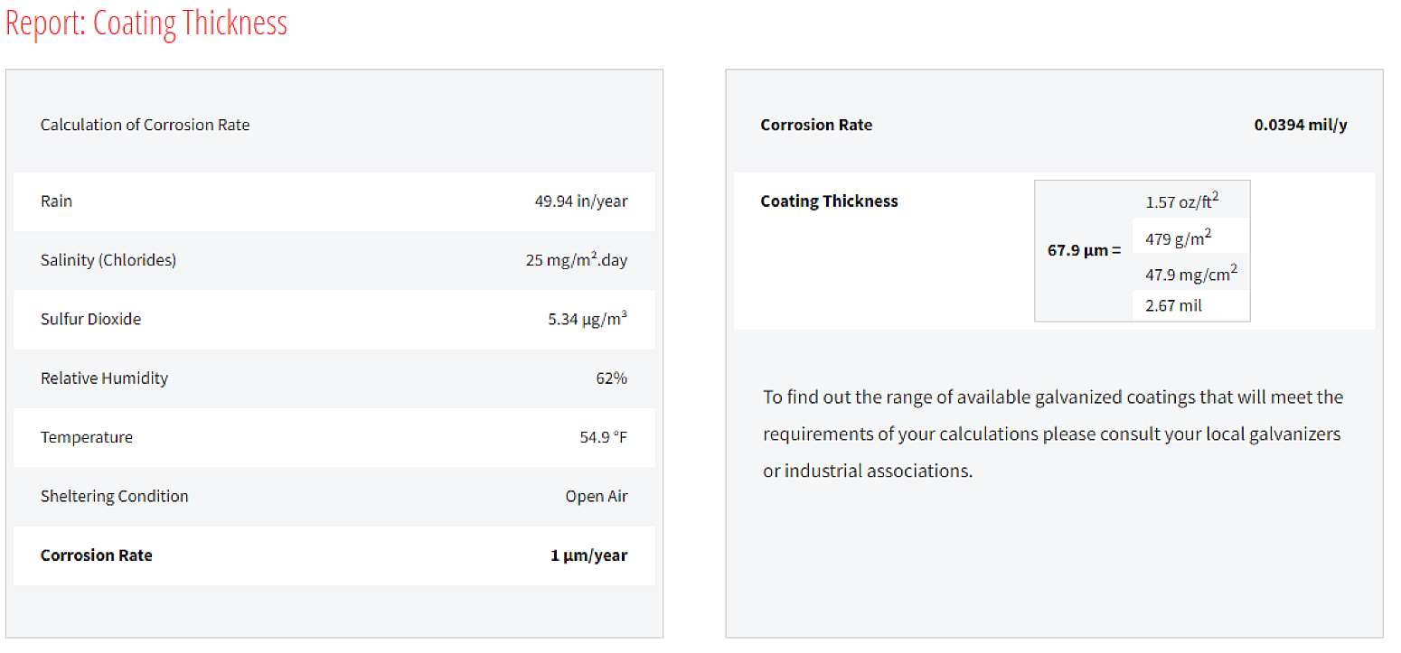

    Calculate Coating Thickness, located at the bottom right-hand side of the page will predict the coating thickness needed to last a specified amount of time based on the environmental factors previously specified. As an example, we can say the desired design life of the Tappan Zee Bridge is 75 years. This time can be entered into the ZCLP; also keeping in mind that this is only the amount of time it will take for the initial coating to corrode away. With minor touch up and repair of the coating at this time, the steel will be protected years beyond this point. Seventy five years is input into the ZCLP, Calculate Coating Thickness is clicked on, and the model leads us to a new screen (Figure 8).
    The corrosion rate is predicted at 1µm/yr (0.04 mil/yr) with a coating thickness of 67.9µm (2.67 mils) needed to provide corrosion protection the Tappan Zee Bridge for 75 years.
