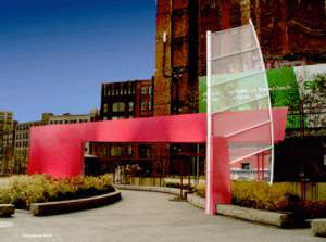

Chinatown Park duplex system
When paint/powder coating and galvanized steel are used together, the corrosion protection is superior to either protection system used alone and can last from 1.5 to 2.3 times the combined lifetimes of both systems. In other words, if you had a paint system that lasts 10 years and a hot-dip galvanized system expected to last 70 years, the duplex system would last 120-184 years if you just let the paint and galvanizing wear away naturally.
