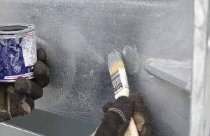

Repair Material Application

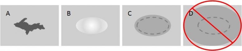

The repair material shall be applied at least two mils thick and according to the environmental requirements for application provided by the manufacturer (i.e. temperature, relative humidity, minimum surface temperature above the dew point, etc.).  During repair material application, always be sure to limit the amount of paint applied to the surrounding area, maintaining the area as small as reasonably possible (See Figure 1).

Figure 1 Example of repair material application. (A) Initial repair size. (B) Prepared surface to bare metal, with minimized extension into the surrounding, undamaged galvanized coating. (C) Repair material applied as small as possible. (D) Over application of repair material to be avoided.
