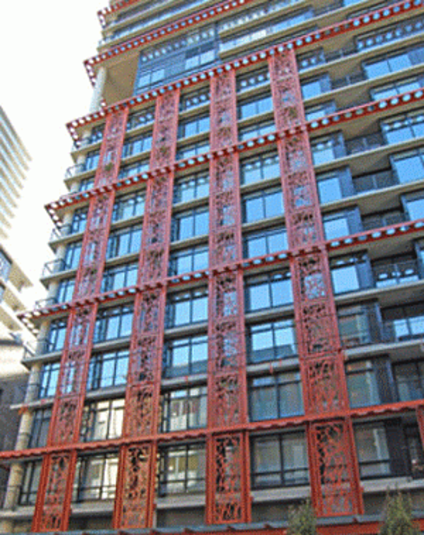

The Woodwards Building W Tower in British Columbia utilized a duplex system of powder coating over hot-dip galvanized steel

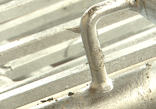

Spkie Drip
Removing bumps, runs, and drips which are deposits of excess zinc produced when the steel is withdrawn from the zinc bath is necessary before powder coating.  These imperfections can protrude through the powder topcoat or create visual issues.  To remove runs, drips, or bumps, the surface is ground or filed smooth and flat commonly accomplished with a hand grinder.  Pure zinc is a soft metal, so caution must be taken to remove the excess zinc material without removing the underlying coating.  The process of removing these excess zinc imperfections with a grinder can leave a dust or powder on the surface; therefore, they must be removed prior to cleaning organic compounds.

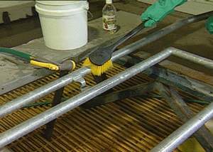

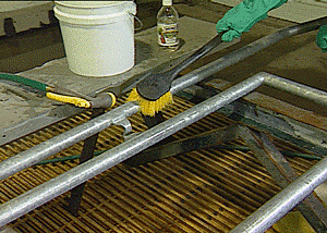

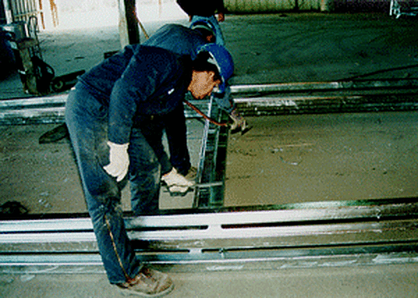

Cleaning the steel surface with a brush
Organic contaminants can also be removed with a mild acidic solution, a mixture of 25 parts water to one part acid. The acidic solution will also slightly etch the zinc coating and leave the surface a dull gray color. Acidic solutions are usually brush applied and should be thoroughly rinsed off the part with fresh water no later than two to three minutes after application. It is good practice to rinse the part twice after using acidic solutions for cleaning.

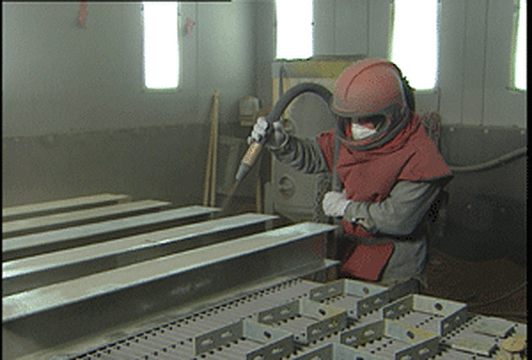

One method to profile the surface is to seep or brush blast the part per SSPC SP16.  Sweep blasting is preferred over standard blasting to avoid damaging the soft zinc coating.  Sweep blasting is angled onto the surface at 30 to 60 degrees, in contrast to standard blasting which uses a 90-degree angle.  Additionally, the selection of abrasive material is important, as some are too abrasive for the zinc coating.  The best practice is to utilize materials with a particle size of 200 to 500 micrometers and a Mohs hardness less than or equal to five.

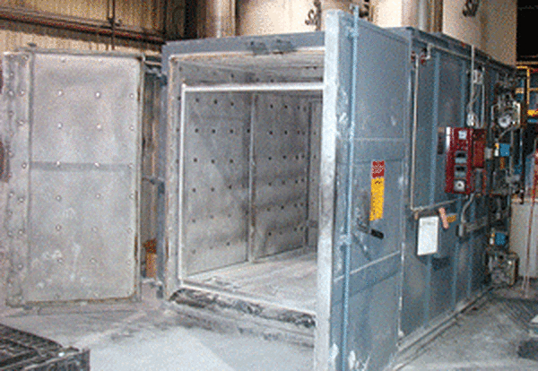

Bake
Small Batch Oven

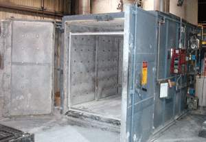

After the galvanized surface has been properly cleaned and profiled, the part is ready for baking.  Water and air molecules can be trapped in the zinc coating, which can turn into pinholes and blisters (outgassing) in the powder coating if the part is not thermally treated prior to coating.  The temperature of the baking oven should be 30 C above the temperature used to cure the powder.  The part should be baked until the part reaches the oven temperature or a minimum of one hour.  The part should then be cooled to a temperature that allows the application of the powder.

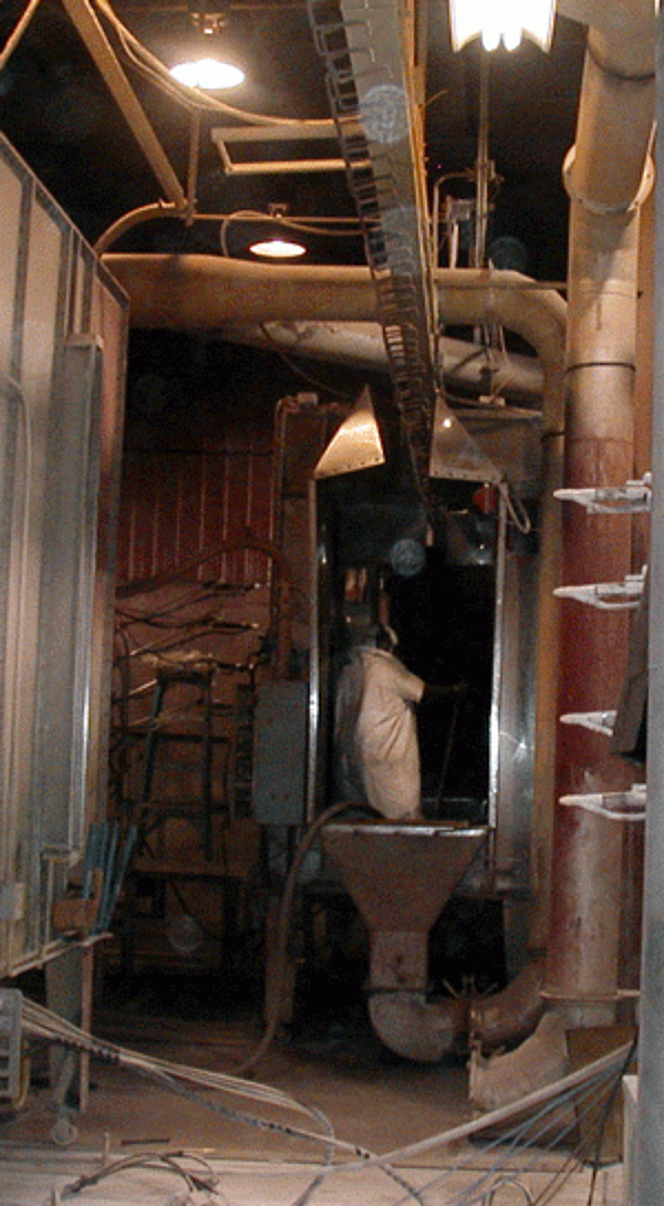

Powder Coat
Powder Application
Powder coating should follow baking as soon as possible so there is little or no time for zinc oxidation to begin. Consult the powder manufacturer for information on powder compatibility with zinc coatings. Apply the powder to the galvanized part in accordance with the manufacturers instructions.  The powder is typically sprayed onto the galvanized surface.  A good practice is to powder coat a sample piece of galvanized steel to check the overall coating appearance before coating the final piece.
