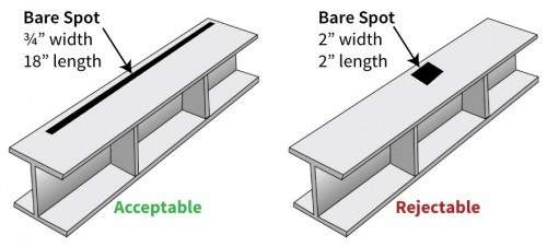

The proposed change includes new language throughout Paragraph 6 to further identify the maximum size of an area that can be repaired, as well as provide a drawing of two areas to be repaired to show in pictorial form the acceptable and rejectable repair areas (Figure 1). At the galvanizing facility, the maximum allowable repair size prior to surface preparation is defined as follows:

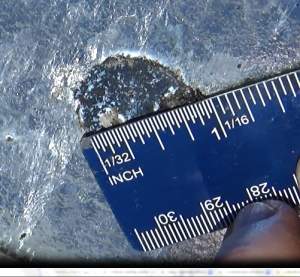

1Inch Bare Spot
Example of 1 inch bare spot
6.2.1 Each uncoated area subject to renovation shall be limited in size. The length and width of the uncoated area shall be allowed to exceed 1 in. [25 mm] in only one of the two dimensions. The figure below depicts the allowable size of an uncoated area that can be renovated.
6.2.2 The total of the uncoated areas subject to renovation by one of the methods in A780 on each steel article shall not exceed ½ of 1% of the accessible surface area to be hot-dip galvanized on that steel article. The total of the uncoated areas subject to renovation by one of the methods of A780 shall also not exceed 36 in.2 per short ton [256 cm2 per metric ton] of piece weight. The size of the uncoated area subject to renovation shall only be applicable at the galvanizing facility. […]
Maximum Repair Size
Figure 1: Uncoated Area Subject to Renovation

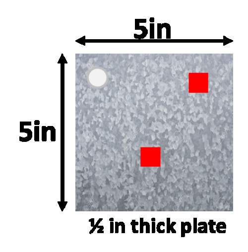

In this example, we have a hot-dip galvanized plate that has two bare spots sized 0.5 in x 0.5 in. To determine if these bare spots can be repaired at the galvanizing facility, we must obtain the following information:
  1. Length (L) and Width (W) of each area to be repaired only one of these dimensions can exceed 1 in Bare Spot:  L = 0.5 in & W = 0.5 in
  2. total surface area (SA) of all bare spots: = (0.5 in * 0.5 in) + (0.5 in * 0.5 in) = 0.5 in2
  3. total surface area (SA) of the part: = 2*5 in*5 in  + 2*5 in*0.5 in + 2*5 in*0.5 in = 60 in2
  4. maximum repair size using 0.5% surface area of the part:  = 0.005 * 60 in2 = 0.3 in2
Even though the dimensions of the bare spots do not exceed 1 inch in either length or width, these bare spots are not allowed to be repaired per ASTM A780. The part is rejectable because the total bare area on the plate before surface preparation (0.5 in2) exceeds 0.5% of the total surface area of the plate (0.3 in2). This plate will need to be stripped and regalvanized according to ASTM A123.

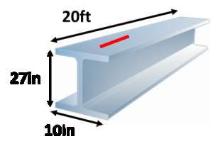

In this example, we have a hot-dip galvanized beam weighing 2,000 lbs that has a bare spot sized 1 in x 40 in. To determine if the bare spots can be repaired at the galvanizing facility, we must obtain the following information:
  1. Length (L) and Width (W) of each area to be repaired only one of these dimensions can exceed 1 in Bare Spot:  L = 40 in & W = 1 in
  2. total surface area (SA) of all bare spots: = 40 in * 1 in = 40 in2
  3. total surface area (SA) of the part: = 10,000 in2 (per engineering drawing)
  4. maximum repair size using 0.5% surface area of the part:  = 0.005 * 10,0000 in2 = 50 in2
  5. total weight of the part in tons:  = 2000 pounds ÷ 2000 = 1 ton
  6. maximum repair size using 36 in2/ton of the part (parts ? 1 ton):  = 36 * 1 ton = 36 in2
This bare spot is not allowed to be repaired per ASTM A780 even though the dimensions of the bare spot exceed 1 inch in only one of the dimensions (length) and the total bare area (40 in2) is less than 0.5% of the beams surface area (50 in2). The part is rejectable because the total bare area on the plate before surface preparation (40 in2) exceeds the calculated value for 36 in2/ton of the part (36 in2). This beam will need to be stripped and regalvanized according to ASTM A123.
