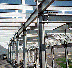

Inspection of hot-dip galvanized steel products does not end once they are accepted at the galvanizer's facility or job site. Once erected, any good corrosion protection strategy includes periodic inspection and maintenance to ensure the protective coating is performing as expected. When inspecting hot-dip galvanized steel in the field, the inspector should be aware of potential accelerated corrosion areas and aesthetic surface defects.
galvanized steel inspection
Field Inspection

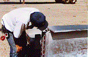

When inspecting a galvanized coating in the field, the number one concern is the number of years remaining before the coating will need to be touched-up or replaced. Fortunately, estimating the remaining time to first maintenance for hot-dip galvanized coatings in atmospheric exposures is relatively simple. For a ballpark estimation, use a magnetic thickness gauge to take a coating thickness measurement and check the thickness value against the AGA's Time to First Maintenance Chart.
In addition to taking coating thickness measurements, the galvanized coating can be visually inspected for signs of accelerated corrosion in specific areas. Thickness measurements should be taken in these areas to ensure adequate zinc coating remains or if touch-up should be performed. Corrosion-prone areas to inspect further include:

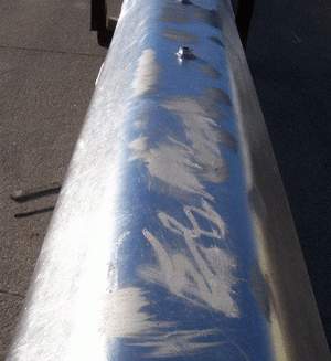

Often mistaken for corrosion, brown staining is a surface defect created when iron in the zinc-iron alloy layers oxidizes. Sometimes hot-dip galvanized coatings form without a free zinc layer, leaving intermetallic layers on the surface. Also, as galvanized steel weathers, the eta layer will be consumed and can lead to this phenomenon. Brown staining forms when free iron in the intermetallic layers reacts with moisture in the environment and oxidizes, discoloring the surrounding zinc coating. To distinguish between red rust and brown staining, simply test the area with a magnetic thickness gauge. If the gauge reading shows a coating thickness, it is brown staining and the corrosion performance of the galvanized coating is not affected. As brown staining is simply an aesthetic concern, touch-up is not necessary for the stained area, and it may be removed by brushing with a nylon bristle brush.

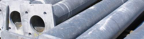

Improper storage and tight stacking of galvanized products can lead to the development of wet storage stain or zinc oxide and hydroxide build-up on the surface. If galvanized products are going to be stored before erection, it is important to properly vent the bundle to avoid the development of wet storage stain.
galvanized steel in field inspection
Wet Storage Stain
Similar to the development of wet storage stain when storing materials, galvanized products in place that have moisture on the surface without the movement of free-flowing air can develop oxides and hydroxides that look like wet storage stain. A common area for this to occur is on surfaces where snow is piled on the surface and left to melt or in areas where water pools for extended periods without drying. Wet storage stain occurs most often during the first month after galvanizing.

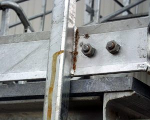

Weeping Welds
Weeping welds can be seen immediately after galvanizing, but also can occur after the steel is in service. As reviewed earlier, weeping welds are mostly a cosmetic concern; however, corrosion can be accelerated in the area where the liquids and rust bleeding are leaking. To clean and seal weeping welds, you can wash away the oxides on the outer area and apply epoxy or caulk to the area to prevent water from penetrating the crevices in the future.

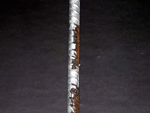

Bare Spots

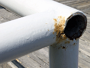

The galvanized coating can be compromised during delivery, handling, erection, and while in use. Some cathodic protection is offered to bare areas of the steel by the surrounding galvanized coating, but these areas can still rust if the area is too wide or corrosive elements frequently attack the steel.
galvanized steel bare spots
Bare Spots
Research has shown the galvanized coating offers cathodic protection to bare areas between 1 mm - 5 mm wide depending on the electrolyte that electrically connects the galvanized coating to the bare area. Bare areas should be touched-up in accordance with the procedures outlined in this publication to ensure the longevity of the surrounding coating.
