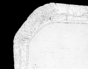

The mechanically plated coating consists of rounded particles of zinc loosely bonded together. The bond between zinc and steel and zinc to zinc is considerably weaker than the metallurgical bond found in hot-dip galvanized coatings by several orders of magnitude. Edge, corner, and thread coating thicknesses are lower because of the deposition method of the mechanical process.
Corner
Although the mechanically plated fasteners appear to be reasonable products, there must be doubts regarding adhesion and the thinness of the coating at the sharp edges of nuts and bolts and thus the corrosion protection provided by this process. These faulty characteristics greatly affect the long-term corrosion protection of the fastener. Insist on hot-dip galvanized fasteners for reliable long-term corrosion protection.
