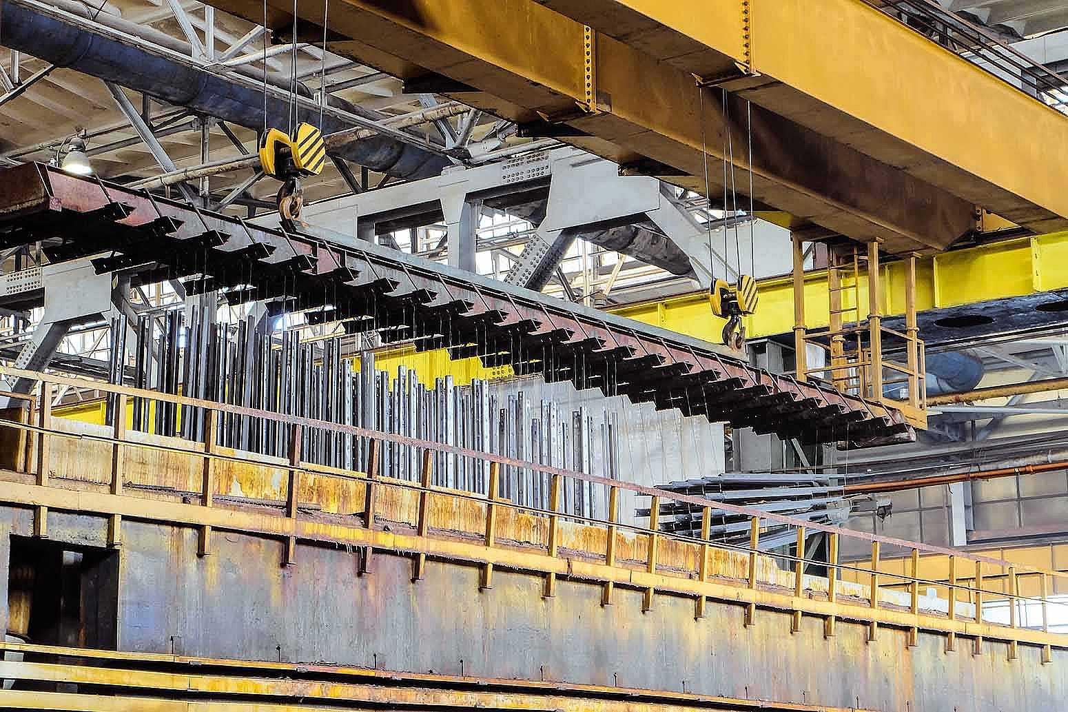

Before cleaning begins, steel is attached to racks, fixtures, or lifting devices.
The orientation of each piece is important because it influences:
  • Chemical cleaning efficiency
  • Zinc flow characteristics
  • Drainage performance
  • Coating appearance
Galvanizers select hanging points that allow solutions and molten zinc to move freely across all surfaces. For large structural members, the positioning process may be carefully planned to maximize coating quality and plant efficiency.
Racking: The process of attaching steel to handling fixtures so it can move safely through the galvanizing process.
Steel racking vertical horizontal 1550w
Vertically and horizontally racked steel attached to a crane to facilitate movement through a hot-dip galvanizing plant

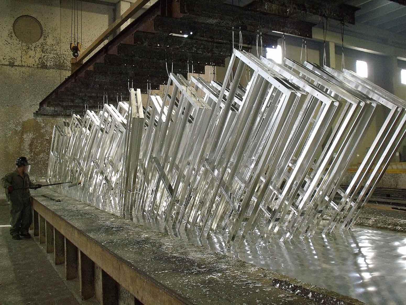

Step 8: Galvanizing
After the steel has been cleaned and fluxed it then moves to the galvanizing kettle. This large process vessel contains molten zinc maintained at approximately 815-850 F (435-455 C), although operating conditions vary among facilities. This is where the defining reaction of hot-dip galvanizing occurs.
Galvanizing Kettle: A specially designed vessel that contains molten zinc used during the hot-dip galvanizing process.
Steel withdrawn from kettle 1550w
Steel being withdrawn from a galvanizing kettle
When steel enters the zinc bath, several metallurgical reactions begin immediately. As the steel warms up to bath temperature, the molten zinc begins to react with iron in the steel, forming a series of zinc-iron alloy layers. Once the reaction is complete, the article is withdrawn from the bath with a layer of pure zinc over the alloy layers. Unlike paints or powder coatings, these layers become part of the steel surface itself.
