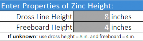

  • Estimated Galvanizing Dross Line Height
  • Estimated Freeboard Height (i.e. gap between the height of the zinc and the top of kettle walls)
The dross line and freeboard heights are important variables in the calculation. The freeboard height affects the overall progressive dip length as the kettle is not filled to the very top with zinc, but typically a few inches below it. If the freeboard height is unknown, it is possible to estimate using 4 inches. The galvanizing dross line height will vary depending on the individual galvanizing kettle maintenance schedule, but articles are often lowered to a point above this line to minimize the potential for dross inclusions (dross pimples) on the surface of the article. For most articles, the presence of dross pimples which do not affect the performance of the galvanizing are acceptable, and a dross line value of 0 inches can be used when looking to maximize the article size which can be hot-dip galvanized. For the minority of articles where the presence of dross is not acceptable (i.e. handrails, architecturally exposed structural steel, articles to be painted or powder coated after HDG), input the dross height, or if unknown it is possible to estimate 8 inches for the dross line height (Figure 3.)
Figure Zinc Properties
Figure 3: Zinc Porperties

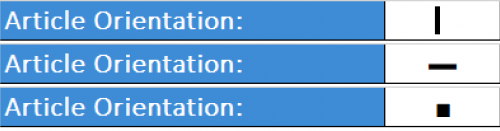

This box will provide you with a visual image of the article’s orientation cross-section within the galvanizing bath when looking at it from the end. This is also to assist you in visualizing how the article is modeled in the bath. Articles with height larger than the width dimension will be represented with a ▎symbol, articles wider than they are tall are represented with a ▬ symbol, and articles with the same width and height are represented with a ■ or square symbol (Figure 4.)

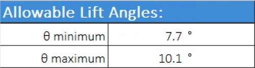

Allowable Lift Angles
This output provides the minimum and maximum lift or rigging angle that will allow for successful galvanizing. If the rigging angle is too low, the article will contact the top of the kettle in the wrong location, it will not immerse to the minimum required depth, and the article may not become fully galvanized. If the rigging angle is too high, not enough of the top of the part will be immersed in the first dip for successful galvanizing. If the range of allowable lift angles is very small to the point the lift angle must be within +/- 1 degree, the designer should evaluate whether suitable lift points are provided to allow for the range of angled lifts, and the galvanizer should evaluate whether they are capable of meeting the rigging tolerances with their available lifting equipment, the available lift points, and the plant layout (Figure 5.)
Figure Allowable Lift Angles
Figure 5: Allowable Lift Angles

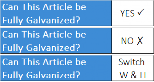

Can this article be progressive dipped?
This box will confirm whether the article can be galvanized fully, either by single dip or progressive dip methods. It also checks whether the article width will fit within the kettle width. For more details on the dip method to be used, refer to the Dip Method output box (Figure 6.)
Figure Can It Be Fully Galv
Figure 6: Can this article be progressive dipped?

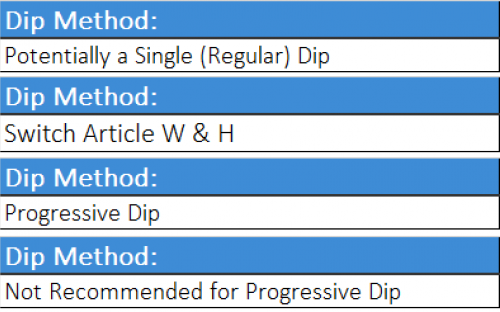

Dip Method
This box informs the user what type of dip methods are available for galvanizing the designated article. Most commonly, the calculator will confirm if the article can be successfully progressive dipped or whether the article is too large and progressive dipping is not recommended. In cases where the angled length of the article is less than the galvanizing kettle length, the calculator will tell you to consider a single dip (regular dip) process. If the article cannot be progressive dip galvanized as it is currently oriented but would be successful if you turned the article by 90 degrees on its side, an error message will tell you to switch the article width and article height. Depending on the venting and drainage details and available lifting points, turning the article on its side (i.e. swapping the article W and H dimensions in the calculator) may or may not be viable option for the galvanizer to pursue (Figure 7.)
Figure Progressive Dip Method
Figure 7: Progressive Dip Method

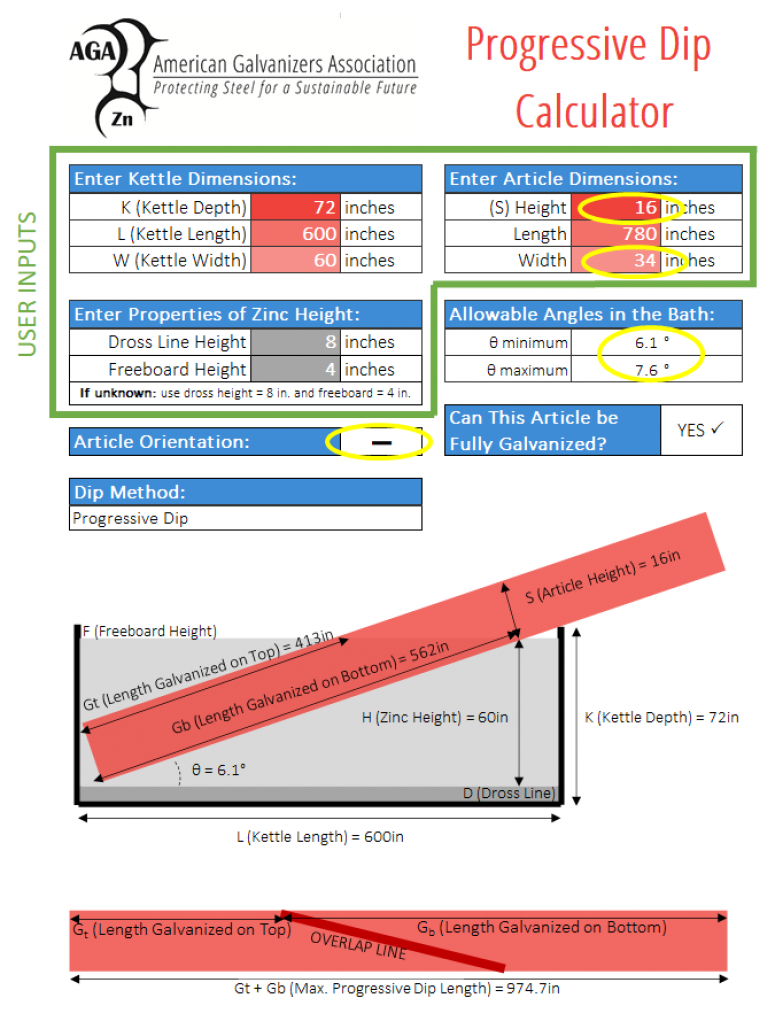

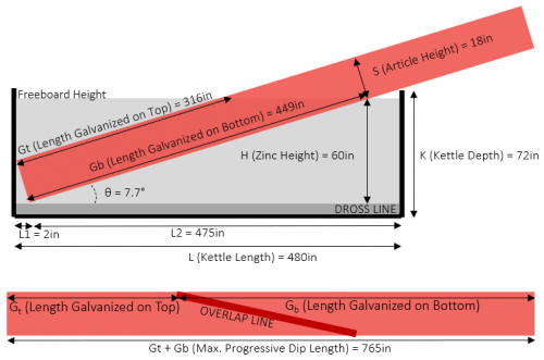

Finally, the outputs are shown on the progressive dip model to further assist you in visualizing the progressive dipping process. Also included is a diagram which provides the maximum article length that can be galvanized with the inputs provided (Figure 8):
Figure Prog Dip Diagram With Values
Figure 8: Final output model diagram from Progressive Dip Calculator

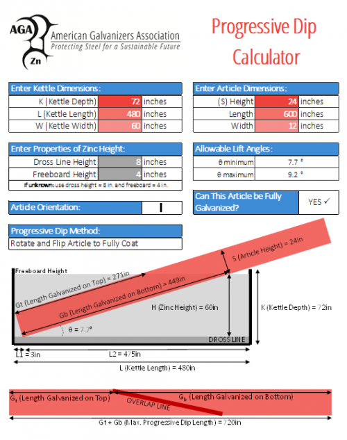

Example Calculation

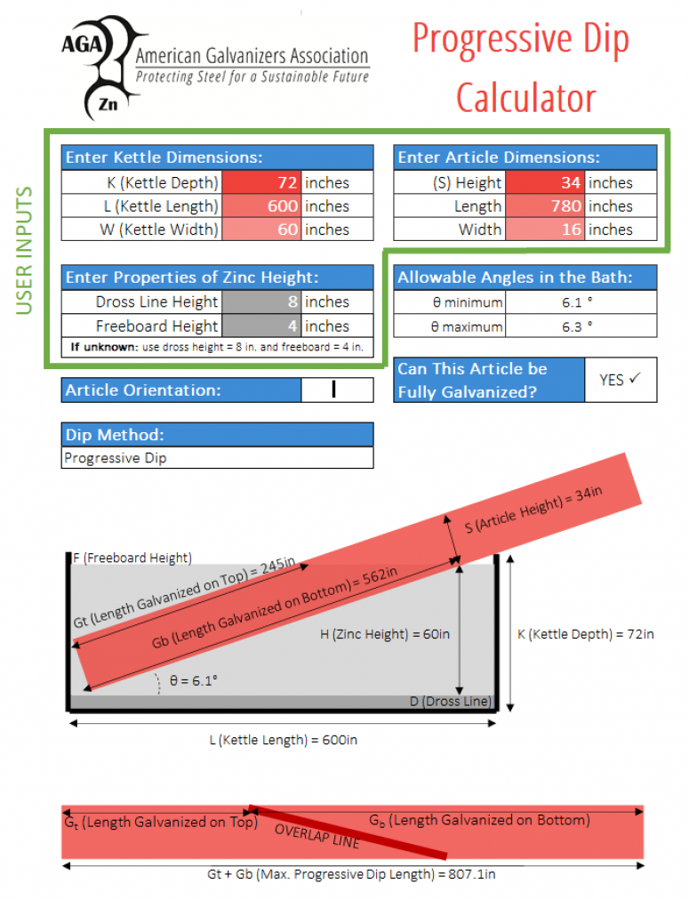

To show you an example, let’s envision you wish to galvanize a beam (W33x221) that is 65' in length in a kettle 6 ft deep, 5 ft wide, and 50 ft long. When unknown, it is possible to estimate a freeboard height of 4 inches and a dross line height of 8 inches. After converting all dimensions to inches, you would provide the following inputs into the calculator:
Figure 7 Example Calculation1
Figure 9: Calculator Example
Based on the inputs about the beam and kettle provided, the progressive dip calculator informs us we can successfully progressive dip the beam in the vertical orientation (flanges on top and bottom) assuming we avoid the dross line and maintain a rigging angle between 6.1 and 6.3 degrees. This small range of available rigging options may be impractical, and so rotating the beam’s W and H may provide more favorable options.
If we switch the beam W and H (highlighted in yellow), we see the following changes to the outputs (also in yellow):
Figure 8 Example Calculation Swtich L And W1
Figure 10: Calculator Example with Article Rotated to Switch L & W Dimensions
The calculator shows us the beam’s orientation has been changed so that the web is facing up/down, and the range of lift angles has increased, allowing more flexibility in rigging arrangements. If needed, further optimizations may be made by reducing the dross height value (this allows the part to be immersed below the dross line, making more optimized use of the available kettle dimensions).
