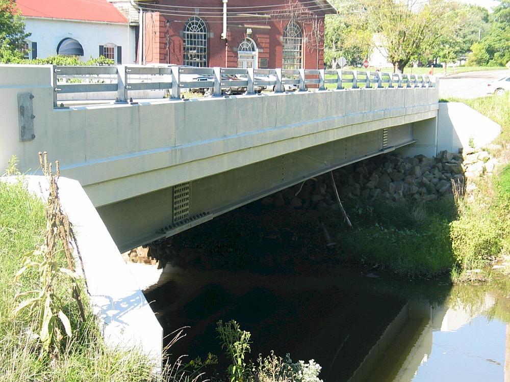

Almost any component can be galvanized by designing and fabricating in modules or sub-units suitable for available galvanizing facilities. Designing structures in modules or sub-units to accommodate the galvanizing kettle often provides additional savings in manufacturing and assembly because they simplify handling and transportation. The sub-units can be connected after galvanizing by bolting or field-welding.
Stark County Ohio Bridge 08
Figure: This bridge from Stark County in Canton, OH is an example of modular design.

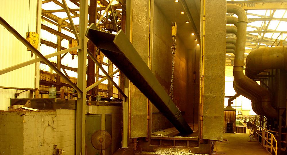

Progressive Dipping
If an item is too large for total immersion in the kettle, progressive dipping can be utilized. This process allows each end of the article to be sequentially immersed in the molten zinc. If at least half the article can be submerged, it can be dipped at an angle, flipped, and re-dipped to achieve full coverage with a small overlapping area. For slender articles or fabrications only a few inches tall, progressive dipping can nearly double the maximum length of steel articles that can be galvanized. However, for larger fabrications (rolled beams, plate girders), progressive dipping may only provide a 15-30% increase in lengths that can be galvanized. You can read more about how progressive dipping is performed in our Dr Galv article, The Progressive Dip Process.

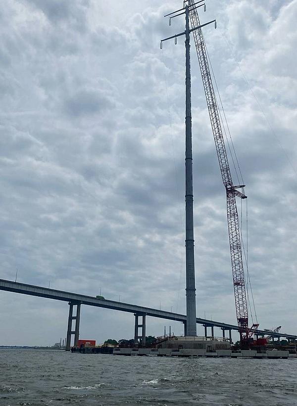

Key Crossing01
Figure: The Key Crossing Reliability Initiative is an excellent example of galvanized structures much larger than any kettle. The towers, some nearly 400’ tall, were designed in modular sections that were then progressive dipped and welded together.

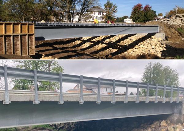

Progressively dipped pieces often have an overlap area that is visible on the piece. The line or darker area is purely cosmetic and will fade over time as the coating weathers naturally. For visual examples of HDG naturally weathering, see Dr Galv article, Examples of Natural Weathering on HDG Appearance. As the overlap area will most likely develop a thicker coating, it is important to consider if the excess zinc will impact a connection point with other pieces and should be avoided, such as for faying surfaces. If required, the excess coating thickness can be buffed or ground down even with the surrounding coating.
Jesup bridge b n a
Figure: Jesup Bridge before and after 10 years of weathering. Progressive dip lines are visible but far less pronounced. Photographs taken Autumn 2013 during installation and Spring 2024.

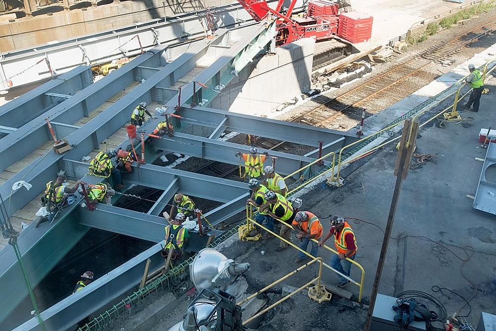

Commonwealth Ave Bridge 2
Figure: Hybrid solution of zinc metallizing of bridge girders, but hot-dip galvanizing of cross frames, lateral bracings, handrail, and other ancillary components.
