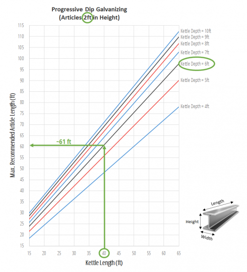

The AGA Progressive Dip Charts are available to estimate the maximum article length which can be galvanized if the article height and galvanizing kettle dimensions are known. There are four charts which provide the output of maximum article length for articles of 1 ft, 2 ft, 3 ft, or 4 ft in height when considering a range of typical galvanizing kettle lengths and depths.
Figure 3 Progressive Dip Chart Images1
Figure 1 – Progressive Dip Charts (Click to Enlarge)
These charts assume the article width is less than the kettle width and that 1 ft of the kettle depth is unused between avoiding the bottom dross layer and to account for a small gap between the zinc height and kettle height.

For example, let’s envision we have a wide flange beam (W24) to be hot-dip galvanized in a kettle sized 40 ft long, 5 ft wide and 6 ft deep. The properties needed to determine the maximum length of W24 beam that can be galvanized is:
  • Kettle Length in feet = 40 ft
  • Kettle Depth in feet = 6 ft
  • Article Height (rounded up to the nearest foot) = 2 ft
Because the article height is 2 ft, we can use Chart No. 2 entitled Progressive Dip Galvanizing (Articles 2 ft in Height). First locate the kettle depth on the horizontal axis, and draw a line up to the curve associated with a kettle depth of 6ft (see Figure 3).
Figure 3 Example Using Prog Dip Chart
Figure 3: An example of using the Progressive Dip charts to estimate the maximum progressive dip length for an article 2ft in height if using a 40ft long x 6ft deep kettle.
The chart indicates the maximum length of W24 beam that can be progressive dipped within a 40 ft long by 6 ft deep kettle is approximately 61 ft. Again, these charts assume an article’s width is less than the kettle width and that the galvanizer is avoiding immersion of the part in any bottom dross layer.
