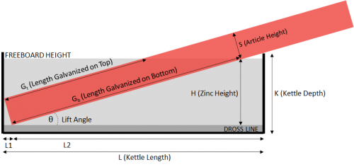

Hot-dip galvanizing is a complete immersion process, which means parts must fit in the galvanizing bath to be fully coated. Size limitations are governed by the galvanizing kettle dimensions, but the average kettle length in North America is 40 ft (12 m) and 50-60 ft (16-18 m) kettles are common. If an item is too large for total immersion in the kettle, progressive dipping can be utilized to immerse each end of the article sequentially to coat the entire item. In other words, if at least half the steel article can be submerged in the galvanizing bath, the part can be partially galvanized at an angle, flipped and rehung, then dipped on the remaining surface to fully coat the entire part with a small overlapping area between (Figure 1). In theory, this can nearly double the size of a parts that can be galvanized when designing in modules or sub-units to accommodate the kettle dimensions cannot be achieved.

In practice, the ability to progressive dip depends on multiple variables. To simplify the calculations, the maximum progressive dipping length is most easily calculated by modeling the article as a solid box (Figure 2).
Figure 2 Prog Dip
Figure 2: Model Used to Calculate Max. Progressive Dip Dimensions
Therefore, to determine the maximum article size that can be galvanized by the progressive dip method, you will need to know or approximate:
  • Part Dimensions (Length X Width X Height)
  • Kettle Dimensions (Length X Width X Depth)
  • Height of the dross from the kettle floor
  • Freeboard height or the distance between top of the zinc and top of the kettle walls

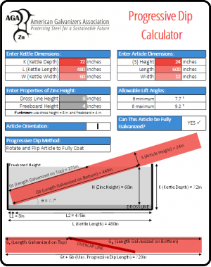

The AGA Progressive Dip Calculator is available to check whether an article of specific dimensions can be hot-dip galvanized within a known galvanizing kettle size. This calculator will not only inform you whether the article can be progressive dipped successfully in the galvanizing kettle, it will also provide:
  • Minimum and maximum rigging angles for successful galvanizing
  • Successful article orientation, or whether rotating the article (W and H) affects galvanizing success.
  • A visual 2D model of the progressive dip method labeled with the outputs from the calculator.
