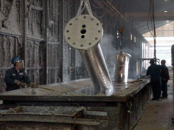

“Maximum size” for oversized hot-dip galvanizing (HDG) is set by the galvanizing kettle’s usable length, width, and depth, plus the plant’s ability to rig and manipulate the fabrication safely at a workable immersion angle. If the part fits in the kettle on paper but the crane cannot lift, rotate, or clear the building, the item cannot be galvanized.
Use the AGA’s Galvanizer Locator to see if nearby kettles can accommodate your design. We do however, always recommend discussing a close fit with the galvanizer. Nobody knows their kettle and plant capacities better than the galvanizer, and many have found creative ways to accommodate awkward or oversized pieces using depth, diagonal positioning, and kettle corners.
Kettle length, width, and depth are the hard geometric limits because hot-dip galvanizing is a complete immersion process, and the part must physically fit into the molten zinc bath. AGA guidance cites typical North American kettle sizes in the range of 30-60 ft (9-18 m) length, 5-8 ft (1.5-2.4 m) width, and 6-12 ft (1.8-3.6 m) depth. Those numbers matter because they let you screen feasibility at concept stage before you spend hours detailing stiffeners, copes, and hole patterns.

Progressive dipping basics matter because it sounds simple in a meeting and becomes complex in detailing. The galvanizer immerses one end, withdraws, then immerses the other end to coat the full length. Progressive dipping should always be evaluated in consultation with the galvanizer because feasible immersion angles, overlap locations, handling methods, and distortion risks vary by facility.
Another consideration with progressive dipping is the overlap zone, which can create a visible line where the two dips meet. The line is cosmetic and weathers over time, but engineers still need to keep that zone clear of bearing surfaces, slip-critical faying surfaces, or architecturally exposed locations where the owner will reject a visible transition.
