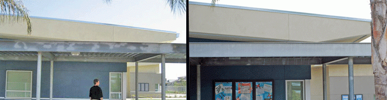

Many specifiers think newly hot-dip galvanized parts will be shiny and spangled; similar to continuous sheet galvanized steel products. In reality, batch or after-fabrication hot-dip galvanized steel can take on a number of initial appearances including bright and shiny, spangled, matte gray, or a combination of these. The initial appearance is often difficult to predict for a variety of reasons, but is most influenced by steel surface chemistry, cooling rates, and stresses induced during steel processing. Regardless of the initial appearance, all galvanized steel parts will take on a uniform matte gray appearance upon exposure to the environment, typically within six months to two years.
Exposure to the environment allowed this canopied walkway at Mark Twain Elementary in Riverside, CA to become uniform after a couple years.

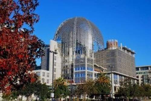

In 2020, be on the lookout for a new video series which will more closely demonstrate the impact fabrication practices, steel selection, and the galvanizer have on the appearance and quality of hot-dip galvanized coatings. Topics to be explored in the Hot-dip Galvanized Coating Appearance video series include:  Steel Chemistry and Cooling Rates, Welding, HDG Process Influences, and Post-Galvanizing Considerations. In addition to the video series on appearance, the AGA is developing visual samples and an instructional guide to assist specifiers wishing to hot-dip galvanize Architecturally Exposed Structural Steel (AESS). Currently, there is a common misconception it is not possible to obtain AESS quality galvanized steel because many surface conditions normally acceptable in the primary galvanizing standards (i.e. runs, skimmings, roughness, excess zinc) may not be acceptable for showcase or feature elements without additional and costly detailing by the galvanizer and/or fabricator. To address these concerns, the AGA is working to develop a supplemental guide to AISC/CISC’s existing guides using the AESS Custom category. This guide will also include best practices to facilitate communication, minimize cost premiums, maximize aesthetic appearance through a combination of design, fabrication, and galvanizing techniques. This guide is also scheduled for publication in 2020.
The San Diego Library is an example of a successful galvanized AESS project.
