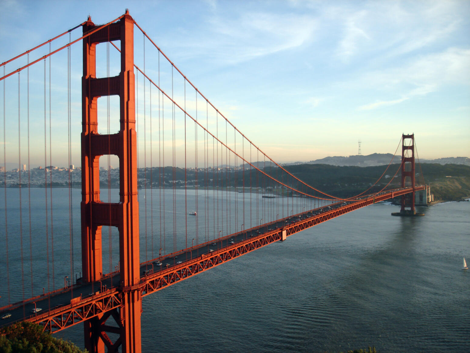

An iconic landmark known worldwide since its opening in 1937 is the 4,200 foot-long main span Golden Gate Bridge, connecting Fort Point in San Francisco to Marin County. Its name actually comes from the body of treacherous water over which it crosses, originally named Chrysopylae by Captain John C. Fremont in 1846, and now known as the Golden Gate Strait. The Golden Gate Bridge was originally painted and has been continuously painted ever since, racking up huge costs. But what if all the structural steel used to erect the bridge had been hot-dip galvanized? Would that even be practical given the scope of the project?
Most galvanizing operations today have kettles/tanks of molten zinc approximately 42 to 60 long and would not have been able to handle the very large and long structural beams used on the bridge. The galvanizing kettle at the time would have had to be about 100 long, holding 5 million pounds of molten zinc. What would the economic comparison look like? Unlike 2014, where hot-dip galvanizing is often less costly than paint systems, galvanizing in the 1930s was likely about 15% more expensive initially than the first coat of paint, but life-cycle cost, the total of all maintenance costs over the lifetime of the bridge, would surely have delivered large cost savings if the bridge were hot-dip galvanized. To answer those questions, lets first take a look at some of the specifications for this aging marvel of engineering and construction.

The Golden Gate Bridge was the largest suspension bridge in the world prior to the construction of the Verrazano-Narrows Bridge in New York 27 years later. All 24,000 tons of the two main cables, suspension cables, and accessories were hot-dip galvanized and painted the unique orange-vermilion color called international airway orange. The original architect chose this color to make the bridge more visible in the regular fog above the water. An additional 83,000 tons of structural steel used for the suspended structure (24,000 tons), anchorages (4,400 tons), approaches (10,200 tons), and two 746 tall towers (44,000 tons) was painted with a lead-based paint from the outset, taking a full 27 years of touchup to complete. There are 1.2 million rivets used in the connections.
In 1965 the decision was made to remove the lead-based paint and apply a zinc silicate primer and a vinyl topcoat. That effort took a full 30 years to complete, and since 1995 there have been 38 full-time painters applying an acrylic topcoat and 17 iron workers replacing corroded steel on the bridge.

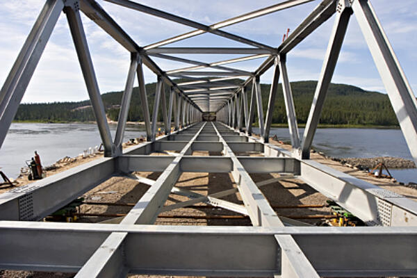

Churchill10
Churchill River Bridge in Goose Bay Labrador, Newfoundland
