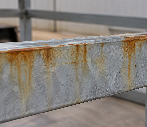

Rust staining
Rust staining/transfer onto the galvanized steel
Rust Transfer and Surface Contamination
Rust transfer is one of the most misunderstood conditions encountered on galvanized steel. It occurs when corrosion products from nearby carbon steel become deposited onto the galvanized surface. Common sources include:
  • Carbon steel dunnage
  • Grinding dust
  • Welding debris
  • Iron filings
  • Rusting shims or hardware
A typical example involves galvanized base plates stored next to uncoated steel materials. Rainwater carries iron oxide onto the galvanized surface and leaves behind orange or brown streaks. The stain may appear severe, but the zinc coating underneath remains fully intact. In many cases, wiping the area with a cloth or lightly brushing the surface removes the contamination and reveals sound galvanizing beneath. Inspectors can always verify coating thickness after removal of rust.

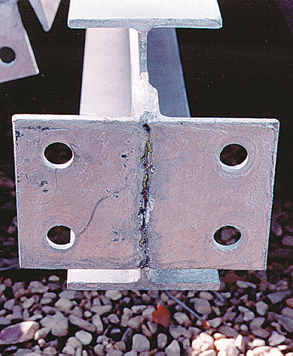

Why Rust Bleeding Is Different
One situation that often causes confusion is rust bleeding at overlapping surfaces.
    Bare Spots Overlapping Surface
    Rust bleeding from overlapping surfaces
    This condition can occur when moisture and residual materials become trapped within narrow gaps between overlapping components. During wet conditions, rust-colored liquid may seep from the joint and create staining on the exterior galvanized surface.
    Common examples include:
    • Overlapping plate details
    • Gusset connections
    • Handrail connections
    • Stair assemblies
    • Intermittently welded joints
    The resulting stain often resembles active corrosion, but the root cause may be hidden within the joint rather than on the exposed galvanized surface. When rust bleeding is observed, cleaning the area and evaluating the joint geometry is generally the first step. If the condition persists, sealing the overlap with caulking can help prevent future moisture intrusion. As with other staining conditions, understanding the mechanism is critical before deciding on corrective action.
