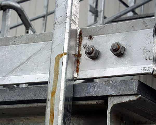

Rust stain weeping weld
Rust transfer/staining from ungalvanized carbon steel beneath weld that is washed out during weathering
Orange Streaks Below Connections, Fasteners, or Edges
Orange streaks extending downward from joints, fasteners, or steel-to-steel connections often indicate rust transfer rather than corrosion of the galvanized member itself.
Examples include carbon steel particles deposited during fabrication, corrosion products washing off adjacent steel components, or contamination introduced during construction activities. Gravity and water runoff frequently create vertical streaking patterns that can be mistaken for coating failure.

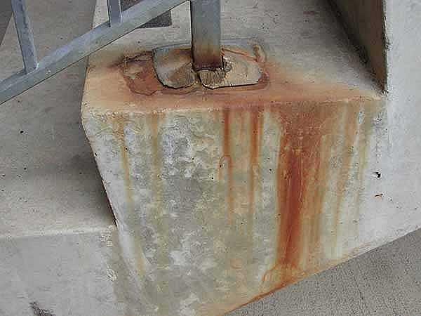

Rust bleed concrete
Water collects in cracked concrete and remains in contact with HDG for extended periods of time causing staining of the concrete.

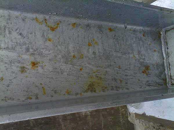

Iron particles from welding prep
Iron particles from welding prep remain on surface causing rust-colored spots
Rust-Colored Spots Near Grinding or Fabrication Activities
Grinding swarf and steel fabrication debris are common causes of staining on galvanized steel. Tiny iron particles become embedded in the zinc surface and subsequently rust, creating isolated reddish-brown spots.
Although unsightly, these spots usually originate from contamination rather than corrosion of the galvanized steel itself.
