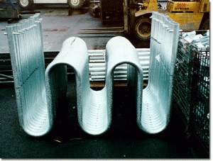

Pipes suffering from wet storage stain.

Cleaning Wet Storage Stain from Galvanized Steel
The best way to treat wet storage stain is to prevent it. Preventing wet storage stain is accomplished in two ways:
  1. Providing adequate air flow to newly galvanized surfaces
  2. Removing standing water from newly galvanized surfaces.
Properly storing newly galvanized steel does both. However, there are times when the formation of wet storage stain cannot be prevented and must be removed. Wet storage stain can range in severity from light to heavy. Light and medium wet storage stain do not affect the service life of the coating, while heavy wet storage stain can. The first step in treating wet storage stain is to dry the galvanized surface. Light wet storage stain can usually be left untreated as long as the surface will remain dry and will be exposed to adequate air flow. Over time the coating will regain its normal appearance as the zinc patina forms. Medium and heavy wet storage stain must be removed from the surface to prevent continued consumption of the galvanized coating. In cases of very heavy wet storage stain, the part may need to be stripped and re-galvanized. The AGA conducted a study to test various products for removing wet storage stain without damaging the galvanized coating or the appearance. Five products were found that meet these criteria:
  •  CLR®
  •  Lime juice
  •  Naval Jelly® Rust Dissolver
  •  Picklex 10G
  •  White vinegar
These products can be applied to the affected areas and then scrubbed with a nylon-bristled brush. After cleaning the wet storage stain, you will need to rinse the surface and dry it.
