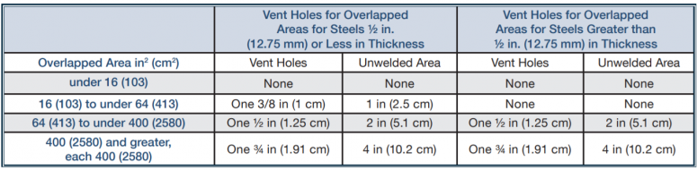

  • Perform seal welding and provide sufficient vent holes or a length of unwelded area as required to prevent weld blowout based on steel thickness and size of overlap area, as detailed in ASTM A385 Tables 1 & 2 (summarized in Figure 1).

Figure Venting Requirements For Overlapping Areas
Figure 1: Venting Requirements for Overlapping Surfaces (ref. ASTM A385 Tables 1 & 2)

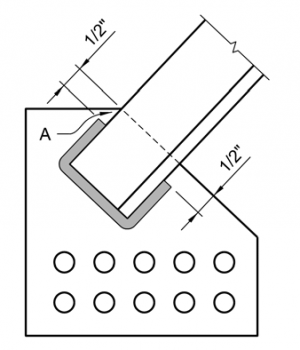

One example of a fabrication involving overlapping surfaces is the design of bridge cross frames which include an overlapping area at the connection between the angles and gusset plates (Figure 2).
Figure Cross Frame Holdbacks Fhwa Illustration 142
Figure 2: Example Bridge Cross Frame Design with Weld Holdbacks (ref. FHWA Bridge Welding Reference Manual, Figure 142)

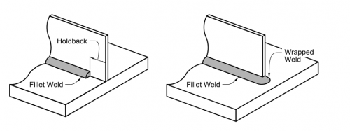

Design best practices involve starting and terminating the weld a short distance before the end of the joint (often specified as a distance equal to the weld size). Known as a weld holdback, this practice helps prevent weld quality issues related to arc blow if the weld were to be extended to the end or when wrap welding (Figure 3.)
Figure Fillet Weld Holdback Fhwa Illustration 167
Figure 3: Fillet weld holdback (left) and wrapped fillet weld (right) (ref. FHWA Bridge Welding Reference Manual, Figure 167)
Depending on the steel thickness and size of overlap area, the specified holdback or otherwise unwelded lengths for this type of design are typically sufficient to prevent issues with weld blowout during galvanizing per ASTM A385 Tables 1 & 2. However, to avoid causing a weeping weld and rust bleeding after galvanizing, either a 3/32” gap must be provided between the overlapping surfaces to allow successful galvanizing of the interior, or seal welding can be investigated with caution.
According to Figure 1, overlapping areas less than 16 in2 (103 cm2) of steel less than ½ in. thick or overlapping areas less than 64 in2 (413 cm2) of steel greater than ½ in. thick can be seal welded without venting and galvanized without fear of weld blowout of the entrapped air/moisture upon galvanizing. However, any seal welding must be ensured or inspected to be free of pinholes or defects so that galvanizing pretreatment chemicals cannot enter the area. Performing a seal weld of suitable quality can be difficult or impossible to achieve depending on welding method, part geometry, accessibility of the welding equipment, and welder skill. Additionally, this practice conflicts with current bridge welding best practices. Therefore, any change to weld termination details should be discussed directly between the engineer, fabricator and galvanizer to discuss feasibility and known difficulties related to ensuring seal weld quality.
