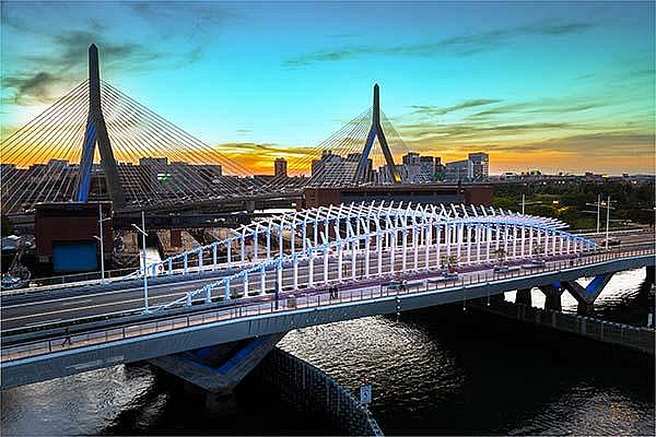

Bill Russell Bridge medium
The Bill Russell Bridge pairs bold architectural flair with relentless durability provided by a duplex system.

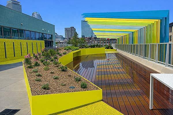

William E Carter School medium
The Architect specified a multi-color duplex system for the exposed structural steel on the William E. Carter school to meet the student's visual, sensory and cognitive goals while still having the corrosion protection and durability of hot-dip galvanizing.

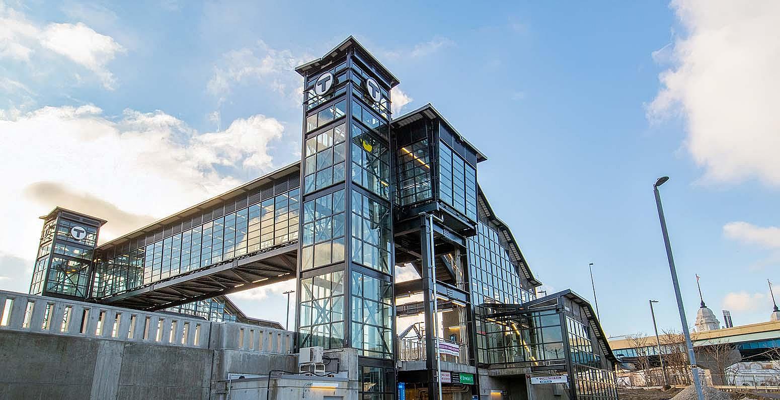

Worcester Union Station large
Worcester's MBTA Union Station employed a duplex system, combining galvanizing with a topcoat to deliver both performance and visual appeal.

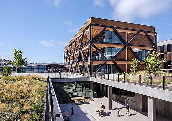

CA College of the Arts medium
Steel elements at the California College of Arts provide critical support to the timber framework, ensuring structural integrity without compromising durability or aesthetic intent.

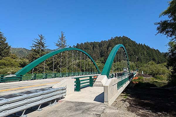

    Panther Creek Bridge medium
    For the Panther Creek Bridge, galvanizing was an important ingredient, ensuring that the public will enjoy this sustainable, low-maintenance bridge for many decades to come.
