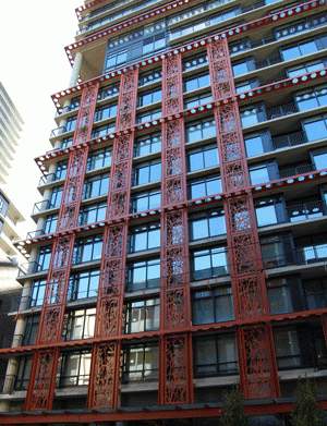

Aesthetics: Matching colors for branding or surrounding structures.
Safety Marking: The extremely high cost to maintain a very tall structure often means galvanizing is a requirement but those same tall structures are mandated to be painted safety orange and white for high visibility to air traffic.
