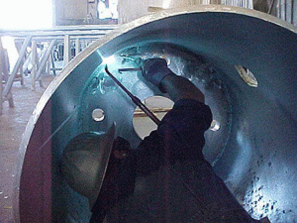

Field welding after galvanizing is sometimes unavoidable, even when best design practices aim to complete all fabrication prior to immersion in the galvanizing kettle. Changes in the field, fit-up challenges, or project modifications can require welding directly on galvanized components. While this approach introduces additional steps, proper procedure ensures the long-term corrosion protection of the steel is maintained.
When welding is performed after hot-dip galvanizing, the zinc coating in the weld area must first be removed to allow for sound weld quality. Following welding, the exposed steel and adjacent heated coating must be repaired to restore corrosion protection.
The repair process is governed by ASTM A780/A780M1, which provides the accepted methods and requirements for restoring damaged or removed zinc coatings on hot-dip galvanized steel. By following this standard and using appropriate surface preparation, welding practices, and repair materials, field-welded galvanized steel can continue to deliver durable corrosion resistance.

How do you remove the galvanized coating in areas to be welded?
The zinc coating is most commonly removed by mechanically grinding the area around the weld to expose clean, bare steel before welding begins.
Removing the coating around the weld zone is essential to assure weld quality. In practice, the zinc coating is typically removed 1 to 4 inches from the weld area on all sides, depending on joint design and welding method. This provides sufficient clearance to produce a sound weld.

Step 2: Remove the zinc coating
Use grinding tools to remove the zinc coating down to bare steel. The goal is to expose clean, sound substrate metal while minimizing damage to the base material. Grinding is the most common method due to its effectiveness and accessibility in field conditions. Sand blasting is not commonly used as it is not typically effective at removing the harder, innermost alloy layer of the galvanized coating (gamma layer).
Care should be taken to achieve uniform removal without creating deep gouges or irregular surfaces that could affect weld quality. The removal area should transition smoothly into the remaining galvanized coating.
By exposing bare steel, the welder can achieve a cleaner arc, improved weld integrity, and reduced cleanup requirements.
