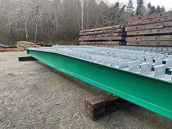

A duplex system combines hot-dip galvanizing with an organic coating such as paint or powder coating. The galvanized coating provides sacrificial corrosion protection, while the topcoat acts as a barrier that reduces zinc consumption and shields the surface from the environment.
For the duplex effect to work, the coating must remain bonded to the zinc. If adhesion fails, moisture can migrate beneath the coating and initiate underfilm corrosion, reducing performance and affecting appearance.

For most duplex systems, the specification should focus as much attention on preparation as on coating selection. ASTM A123 establishes the baseline requirements for the galvanized coating. ASTM D6386 provides guidance for painting galvanized steel, while ASTM D7803 addresses preparation and application requirements for powder coating over HDG.
Regardless of the selected coating, project teams can significantly reduce risk by defining:
- The expected condition of the galvanized surface prior to painting/powder coating
- Responsibility for cleaning and profiling
- Whether sweep blasting is required
- Requirements for outgassing control
- Cure schedules for powder coating
- Acceptance criteria for adhesion and appearance
The most successful duplex systems are not necessarily those with the most sophisticated coating. They are the projects where the galvanizer, coater, fabricator, and owner understand their responsibilities before production begins.
