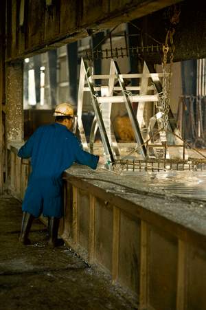

Immersion into the zinc bath in the galvanizing process
Hot-dip galvanizing (HDG) is the process of dipping fabricated steel or small parts such as bolts, nuts, washers, and nails into a kettle or vat containing molten zinc. The process is inherently simple, which provides a distinct advantage over other corrosion protection methods. While the steel is in the kettle, the iron in the steel metallurgically reacts with the molten zinc to form a tightly-bonded alloy coating that provides superior corrosion protection to steel often for 75 years or more. Specifiers understand reducing maintenance to materials over the life of a project is inherently sustainable, which is why many advocate for the use of galvanized steel products. However, there has long been a question (misperception) as to how sustainable the process of producing HDG is and whether improvements are being made in the plants.

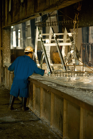

dipping steel in kettle for galvanizing
Energy use in the galvanizing process comprises approximately 20% of the overall cost of production, so galvanizers are constantly committed to driving that cost down, which in turn makes them better stewards of the environment, a measure which is meaningful to them and their customers. Readers of this article will learn how a focus by two specific galvanizers on electric consumption by in-plant lighting systems rewarded them with an 18-month payback on their investment and a long-term, annual savings of $18,000 and $26,000, respectively. Additionally, you will learn how heat capture systems have delivered major reductions in natural gas consumption across much of the industry. Fundamental to the process is the use of significant energy, almost universally clean, natural gas, to heat the zinc metal to a molten state. Because this energy use comprises about 20% of the cost to produce galvanized steel, a reduction in consumption delivers immediate economic value to galvanizing companies but just as importantly a step toward their being more sustainable.

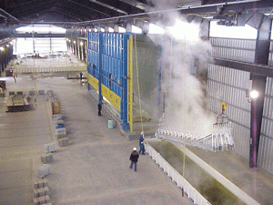

hot-dip galvanizing kettle with enclosure
Secondly, lets look at heat capture systems within the hot-dip galvanizing process itself which represents an initial investment by the galvanizer of $40,000 to $60,000, not a small sum for a plant which may generate only about $6 million to $10 million in annual sales. The kettle or vat of molten zinc is contained on five sides, with an open top where the bare steel is lowered into the molten zinc. A natural gas-fired furnace applies heat to the four sides of the kettle to initially melt the solid zinc ingots and to keep the zinc molten at 830 F 850 F. This is a 24/7/365 function.
As you would expect, some heat is lost to the atmosphere in the immediate area of the kettle sides. A common practice in the industry is to locate an exhaust system in the furnace area to capture this escaping heat and collect it via a mechanical system where it is transferred into a heat exchanger. The captured heat, approximately 80% of the exhaust heat, is then used to heat water to steam and then passed through coils to either heat the chemical cleaning solution used to clean the bare steel prior to immersion in the molten zinc or simply to pre-heat the bare steel to minimize the heat loss in the zinc when the steel is first immersed. For those who utilize such a heat recovery system the realized savings are approximately $8,000 to $10,000 per year and the payback period is about 5 years. These types of savings and payback are smart for the galvanizer and good for our environment.
