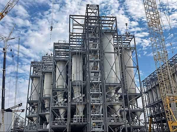

Nestle purina 600w
Hot-dip galvanizing was chosen to protect this food processing facility where low maintenance was their top concern.

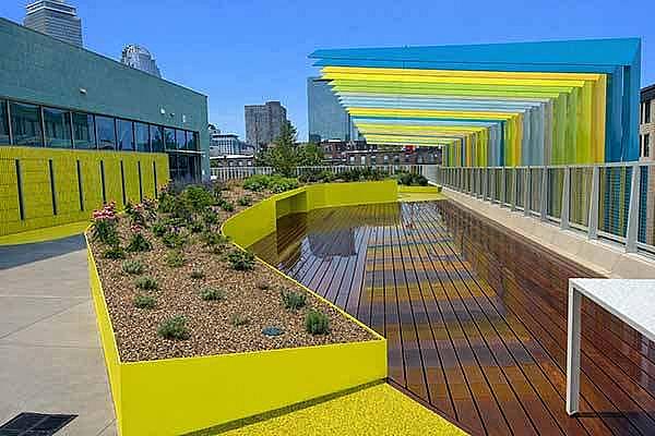

William e carter 600w
A multi-color duplex system was selected for the exposed structural steel on this school to meet the student's visual, sensory and cognitive goals while still having the corrosion protection and durability of hot-dip galvanizing.
