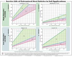

Soil Chart Hi Res 1
In 2011, the American Galvanizers Association (AGA) developed the Service Life of Galvanized Steel Articles in Soil Applications.  The series of four charts provides an estimate of how long hot-dip galvanized steel will last based on three primary soil characteristics: chloride level, moisture content, and pH. The service life is defined as total consumption of the zinc coating plus 25%, which would be when replacement is likely necessary.  The charts are a great tool to estimate the service life at the outset of the project.  However, unlike atmospheric applications where it is easy to visually inspect the galvanized coating, it is much more difficult to know if the galvanized steel is performing as expected below grade (underground).

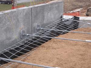

There are a number of products that use hot-dip galvanizing below grade, but one of the most common is transmission and distribution utility poles.  As everyone is likely aware, North America’s infrastructure is aging and in need of improvements.  According to the most recent Report Card for America’s Infrastructure, produced by the American Society of Civil Engineers (ASCE), the Energy Infrastructure is graded as a D+.  A good portion of that grade has to do with the aging electrical grid, some of which was built in the 1880s, but the vast majority was installed following World War II.  Therefore, much of the infrastructure has met or surpassed its original design life, and is likely in need of replacement.
galvanized steel in soil
The “baby boomer” generation of transmission and distribution poles compromise a large percentage of the electrical grid; therefore, it is critical to stay ahead of the deterioration of these structures.  This fact led the Institute of Electrical and Electronics Engineers (IEEE) and the National Association of Corrosion Engineers (NACE) to develop a joint committee to assess these structures and develop standards for the inspection and repair/replacement of the aging poles.  As stated before, the atmospheric evaluation and inspection is relatively simple and well understood.  However, the joint group has also developed standards to assess and inspect the structures below grade, which has implications beyond the utility market.
