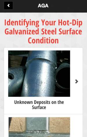

AGA Inspection App home screen

The app is a visual guide to identifying various surface conditions present after hot-dip galvanizing.  “The advantage of a picture-based app is it provides inspectors, architects, and engineers who may be unfamiliar with the specific outcomes of the galvanizing process with a visual example of a surface condition similar to one they are viewing for their particular project,” according to AGA Executive Director Philip Rahrig.
Each image in the app is accompanied by text identifying the industry term for the surface appearance and detailing how and why it occurs, and whether or not it is accepted according to the specification.
Aga Inspection App2
Photos guide the user to the surface conditions, where text explains the cause and whether it is acceptable according to the specification
