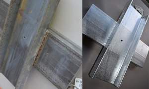

Press Release Image
Series follows samples throughout the fabrication and galvanizing process

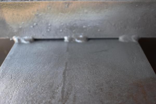

Part two in the Coating Appearance video series pinpoint some specific recommendations in the specification that influence appearance such as steel chemistry, cooling rates and stresses induced from steel processing or fabrication.  Part three focuses on the influence welding techniques have on hot-dip galvanized steel. The quality of the weld plays a significant role in the appearance of the hot-dip galvanized coating and this video provides best practices and considerations when welding before galvanizing.
2 B Stitch Weld With Gap
"Stitch Weld" featured in Part 3: Influence of Welding Techniques
