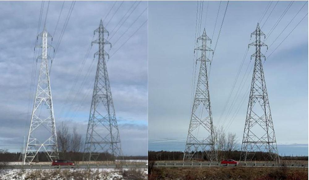

One great example of HDG weathering came from an AGA member in Coteau-du-lac, Canada. A newly galvanized transmission tower was installed next to another, fully weathered, galvanized transmission tower in December 2019 (Figure 5 left). This provided the opportunity to observe the changing appearance over the years, resulting in nearly identical coatings on both transmission towers 4 ½ years later in 2024 (Figure 5 right).
Transmission Tower combo
Figure 5: Natural weathering of hot-dip galvanized transmission towers in Coteau-du-lac, Canada. The left side was photographed in December 2019. The right side was taken in March 2024.
