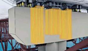

The San Francisco‐Oakland Bay Bridge (SFOBB) is connected to Pier E2 at the east side by means of 96, 3‐inch diameter, galvanized ASTM A354 Grade BD (A354BD) anchor rods fabricated and installed inside the Pier E2 concrete bent cap in 2008 (2008 Rods). In early March 2013, after erection of the superstructure and load transfer was completed, the rods were pre‐tensioned to 70% of their minimum specified ultimate tensile strength (Fu). A few days after tensioning was completed, during the first two weeks of March 2013, 32 of the 96 anchor rods fractured. All 32 fractures occurred at or near the threaded engagements at the bottom ends of the rods. Failure of the rods ceased after the pre‐tension level in the remaining rods was reduced to 0.40 Fu in mid‐March. All of these 96 rods were abandoned and an alternative anchoring system was successfully designed and installed.
