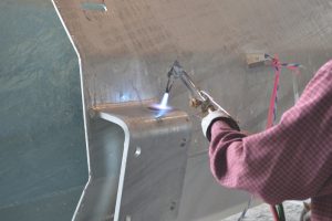

The last three videos detail the three acceptable touch-up and repair materials: metallizing, zinc-rich paint, and soldering. Each video covers how to properly prepare the area to be touched-up as well as how to apply the selected touch-up material. Metallizing deposits molten zinc droplets onto the surface of a galvanized coating via a flame or electric arc and closely matches the appearance of the galvanized coating. Zinc-rich paints are the most commonly used repair materials, and can be either sprayed or painted onto the uncoated area. The last video covers zinc-based solders. These zinc-based alloys blend well with the existing coating material and are applied by heating the metal surface and melting the alloy onto the heated metal.
