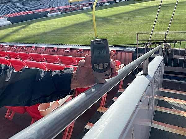

Stadium handrails
These handrails were in service for 20 years and have 3.0 mils of zinc remaining. In a C3 (Suburban) environment they will last another 75 years.

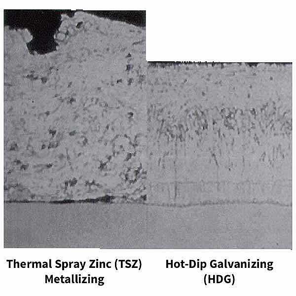

Tsz vs hdg coating thickness density
Thermal Spray Zinc (TSZ) metallized coatings are more porous and less dense than hot-dip galvanized (HDG) coatings.
Hot-dip galvanized coatings have a denser zinc concentration than other zinc coatings. For example, because of porosity, a metallized or thermal spray zinc (TSZ) coating has approximately 15% less zinc than a hot-dip galvanized coating of the same thickness. This directly translates to a longer maintenance-free service life for HDG coatings compared to equivalent thickness TSZ coatings.
