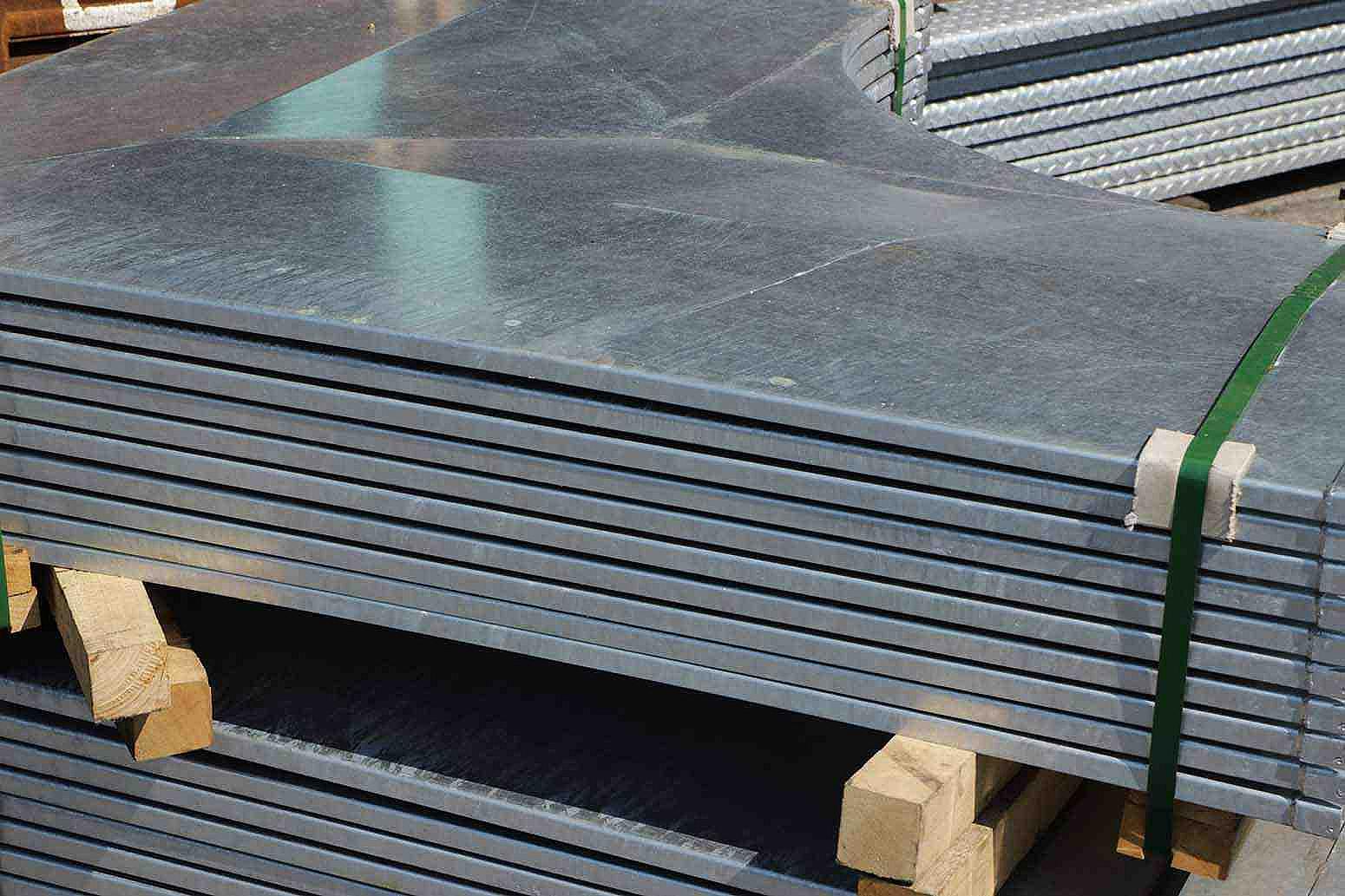

Bright, Shiny Galvanized Coatings
Shiny coating 1550w
Bright zinc surfaces typically occur when a relatively thick outer layer of free zinc remains on the coating surface after withdrawal from the galvanizing bath. Faster cooling rates often promote this appearance.
Bright coatings are common on:
  • Thin steel sections
  • Edges and corners
  • Fast-cooling components
  • Certain structural shapes and fabricated assemblies
A bright finish should not be interpreted as superior protection. It simply reflects the coating structure present at the time of solidification.

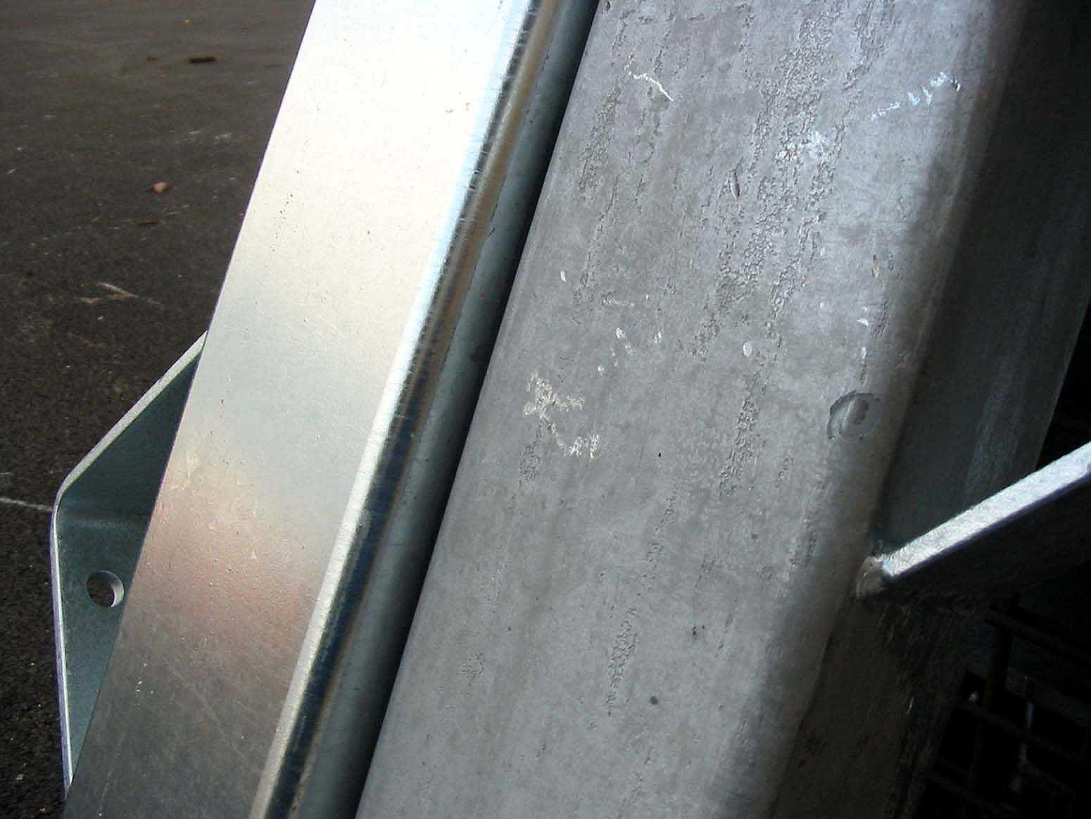

Matte Gray Galvanized Coatings
Matte gray coating 1550w
Matte gray coatings develop when zinc-iron alloy layers extend to the coating's outer surface. These coatings commonly form on steels with more reactive chemistry or on large components that cool slowly following withdrawal from the zinc bath.
Matte gray coatings are often associated with:
  • Reactive steel chemistry
  • Greater alloy layer growth
  • Thicker zinc coatings
  • Heavy structural sections
Although noticeably different in appearance from bright coatings, matte gray surfaces provide exceptional protection so long as coating thickness requirements are met.

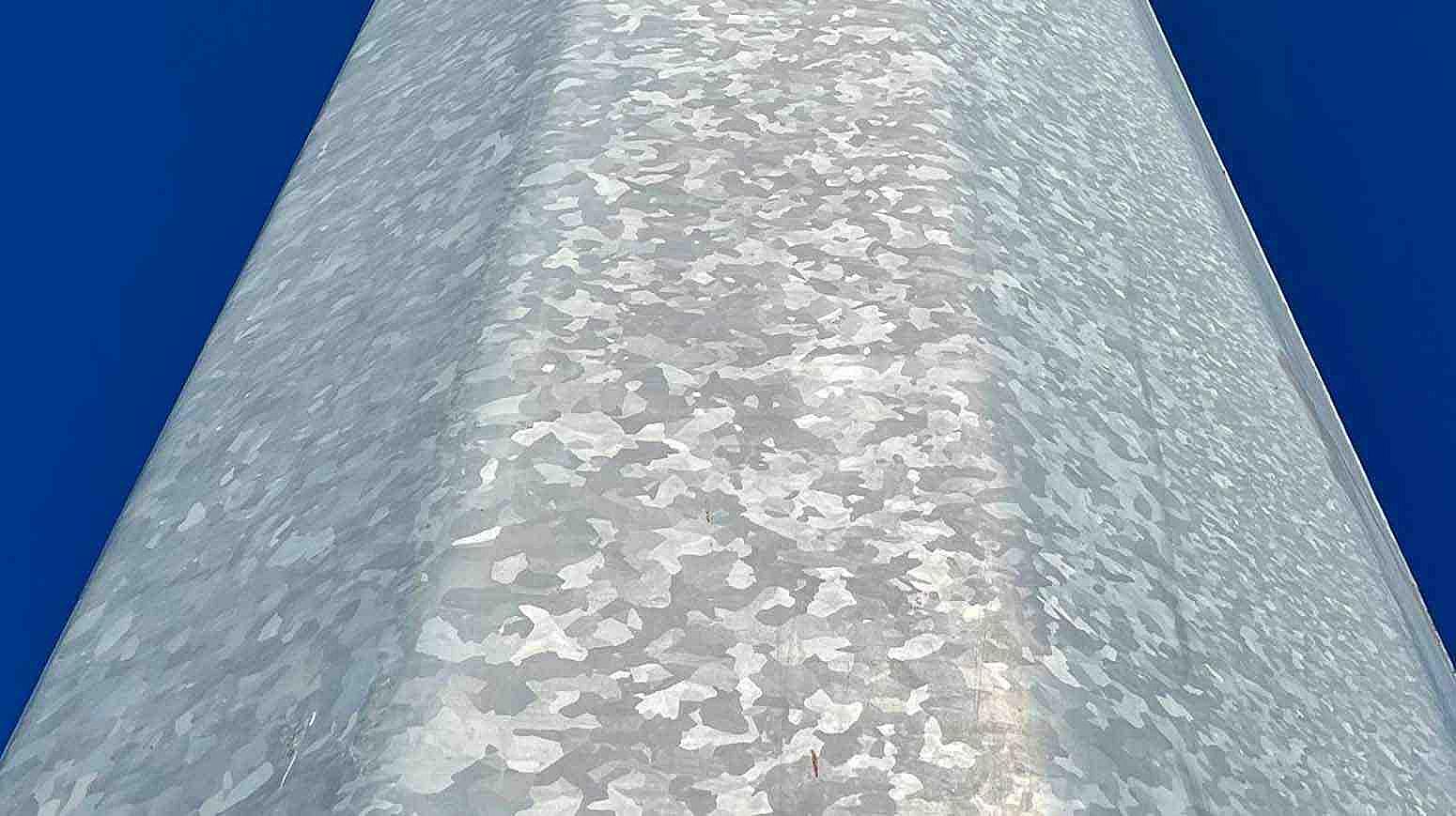

Spangled Galvanized Coatings
Spangle coating 1550w
Spangle refers to the visible crystalline structure that forms as molten zinc solidifies, sometimes referred to as "flowers of zinc." The presence of spangle on the galvanized coating is the result of minor bath additions forming alloy crystals with zinc. Elements that produce spangle include lead, tin, aluminum, cadmium, antimony, copper and a variety of others.
Spangle is primarily an aesthetic characteristic and does not indicate coating quality or expected service life.

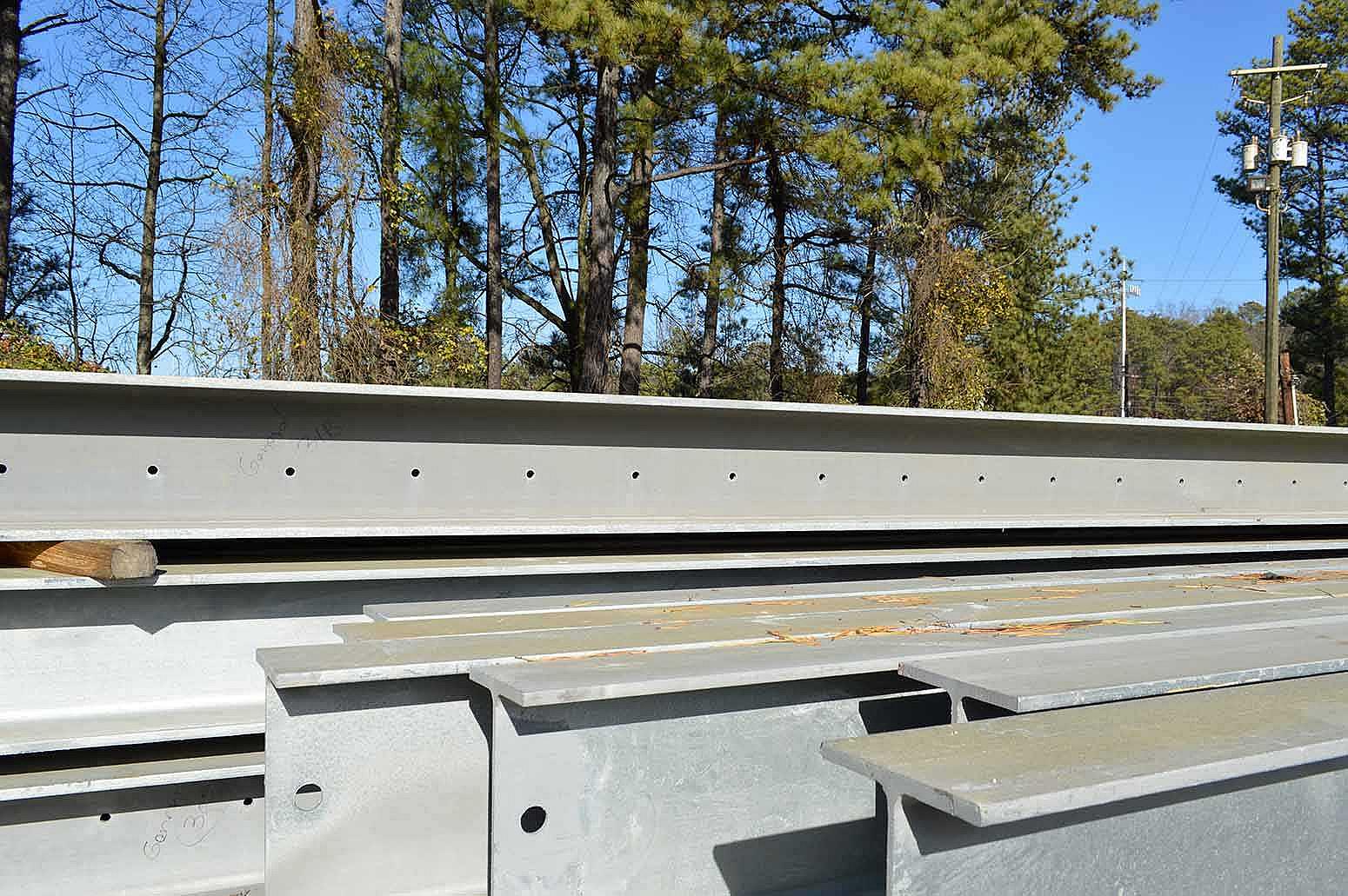

Mixed Galvanized Finishes
Dull shiny coating 1550w
Galvanized assemblies frequently exhibit both bright and matte areas on the same piece. Variations in steel chemistry between components, differing section thicknesses, and localized cooling conditions all contribute to these mixed appearances.
Examples commonly include:
  • Welded assemblies fabricated from different steel heats
  • Plate-and-angle combinations
  • Thick-to-thin section transitions
  • Built-up structural connections
These appearance variations are commonly experienced with mixed steels and are not indicative of coating deficiency.

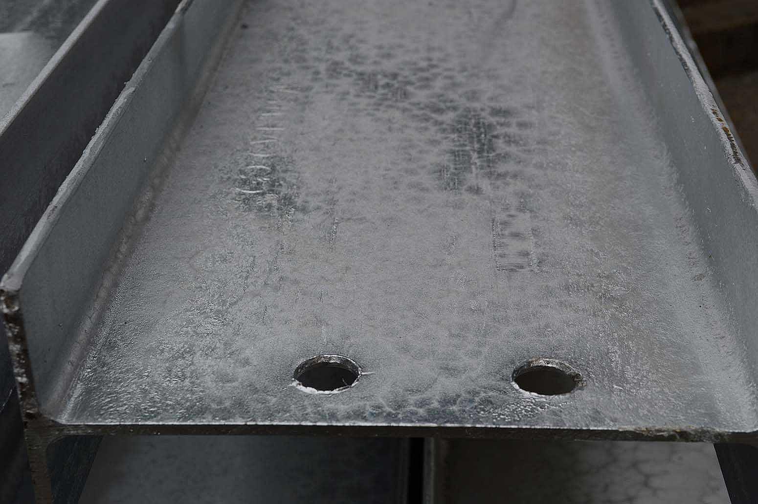

Mottled Galvanized Coatings
Mottled coating 1550w
A steel part with both dull and shiny coating can also be the result of a different cooling rate. In the example, (right) the outer edges of the product were cooled rapidly, allowing a free zinc layer to form on top of the intermetallic layers. The center of the product remained above 550 F longer and the metallurgical reaction between zinc and iron continued in the solid state consuming the free zinc layer, resulting in a matte gray look.
  • Air-cooled parts
  • Edges and holes
  • Slow-cooling components
Mottling is simply an HDG coating made up of different zinc-iron alloy layers.
