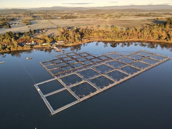

Marine Splash Zones
Marine immersion and marine splash conditions should not be considered equivalent.
In splash zones:
- Salt deposits continuously introduce chlorides to the galvanized surface.
- Wetting and drying cycles repeatedly expose fresh zinc.
- Wave action and spray can remove protective surface deposits before they become fully established.
- High oxygen availability accelerates corrosion reactions.
Wash zones, splash zones, and tide lines are among the most corrosive water-related environments for galvanized steel because protective scales are regularly removed and fresh zinc is continually exposed.

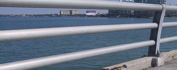

4. Marine Splash Zones
Marine splash exposure combines chlorides, oxygen, agitation, and repeated wet/dry cycling into a single environment. Although these environments add to the risk of corrosion, hot-dip galvanized steel still offers relatively strong protection, especially when supplements by another coating. Duplex systems are one method used to provide an additional layer of barrier protection and may be warranted depending on the required service life.
