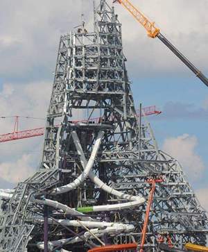

Figure 1: The completed hot-dip galvanized frame structure for the Krakatau Volcano at the Universal Studios Volcano Bay attraction.

In fact, new waterpark projects continue to be specified as a result of hot-dip galvanizings demonstrated longevity in this type of application. In 2017, the Universal Studios design team specified hot-dip galvanizing for the enclosure and total support structure of Krakatau Volcano, the centerpiece for the highly anticipated Volcano Bay attraction (Figure 1). This decision was largely based on positive experiences with galvanizings maintenance-free service on previous waterpark projects throughout the park. By selecting hot-dip galvanizing, Universal Studios will ensure Krakatau Volcano will be enjoyed by Floridians and the millions of tourists who visit Orlando's theme park annually.

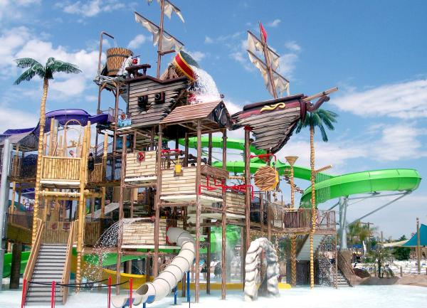

While duplex systems can provide an additional layer of protection in the pool water environment, they also allow for the colorful and exciting appearance expected from a waterpark. Depending on the look the owner is trying to achieve, steel components can be themed based on the subject matter of the park or ride. For example, many of the rides at Six Flags Hurricane Harbor in Los Angeles, CA (2006) include duplexed vertical components which were hand painted over the powder coating to look like the trunk of decorative palm trees (Figure 2).
Six Flags Hurrican Harbor 02
Figure 2: Six Flags Hurricane Harbor

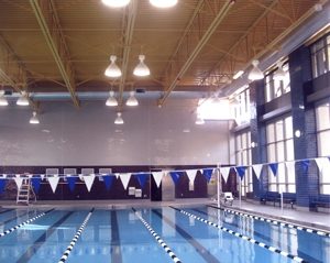

Figure 3: North Arundel Aquatic Center, where a Duplex System continues to provide corrosion protection to columns, beams, joints and miscellaneous metals around the pool and building.

According to International Organization for Standardization guidelines for categorizing atmospheric environments, indoor pools and aquatic buildings are categorized as a C4 environment, similar to coastal areas with moderate salinity or industrial environments. Despite the highly corrosive atmosphere, hot-dip galvanized structural steel has demonstrated good performance when used indoors above both chlorine and saltwater pools. Though often a humid environment, hot-dip galvanizing can provide suitable protection to columns, roofing beams, joists and miscellaneous steel around the pool area since direct exposure to chlorine is minimized. Where structural steel components within an aquatic building are hidden (e.g. behind a suspended ceiling), hot-dip galvanizing alone is often suitable for long term corrosion protection. However, a duplex system is recommended for increased longevity of any visible steel components.
North Arundel Aquatic Center in Glen Burnie, MD (Figure 3) is an example where hot-dip galvanized steel has certainly demonstrated longevity positioned above pool water in an indoor facility. In 2006, the roof structure and various columns were duplexed specifically to protect the building from corrosion while complimenting the primary colors of the indoor playground, staircases and slides. As a result, the aquatic center has been a great source of leisurely entertainment over the years for the local community.

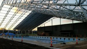

Figure 4: Cheshire, CT Community Pool. This hot-dip galvanized and fabric tension membrane roof will allow the people of Cheshire to enjoy having a place to meet, swim and socialize with their community, year-round for many years to come.

Hot-dip galvanizing can provide additional benefits for outdoor pool environments. Hot-dip galvanized pool structures are not damaged by UV, have superior abrasion resistance, and can provide maintenance-free protection of structural components. The tension membrane roof skeleton of the Cheshire, CT community pool is one such structure demonstrating protection from the elements. The roof, made of galvanized steel and tensile fabrics, provides shade and protection from corrosion while maintaining the outdoor pools open, airy feel (Figure 4). Positioned above the water, the hot-dip galvanized components are still capable of providing effective corrosion protection since direct contact with chlorine is minimized.

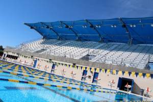

As demonstrated by the specification of HDG for the Northside Swim Center in San Antonio, TX, the coating is also suitable for nearby stairways, handrail, and stadium components around the outdoor pool area (Figure 5). For this swim center, hot-dip galvanizing will provide the durability and longevity required to host spectators year after year at the impressive 50 meter Olympic-size swimming pool and 25 meter diving pool.

Figure 5: Northside Swim Center where HDG was specified for 40 years of maintenance and operation and is expected to provide coating durability in the high chlorine atmosphere as well as abrasion resistance from spectators wear and tear.
